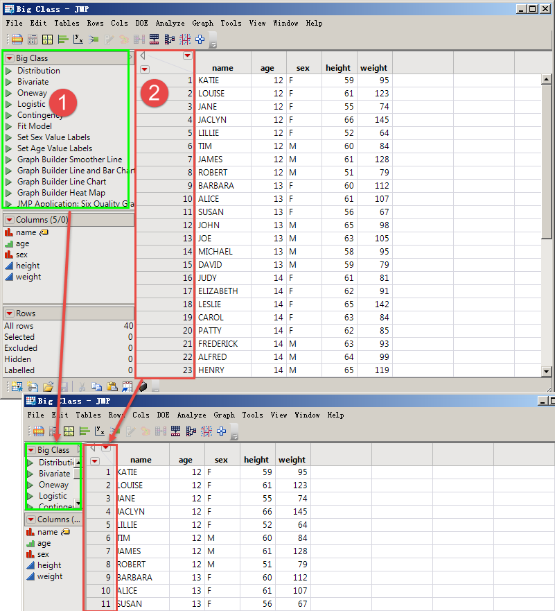

如何用脚本调整数据表中左面板及行号面板的宽度及脚本面板的高度?
大家好!
谢谢!

I think that SplitterBox doesn't control the height. You can try to test this with
sp << get xml
and maybe see which values to change (if they can be changed)
Row "column" width can be adjusted with
dt << Set Row ID Width(15);
Search scripting index for DataBrowserBox for possibly more suggestions
-Jarmo

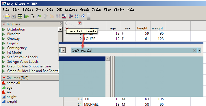

回复: 如何用脚本调整数据表中左面板及行号面板的宽度及脚本面板的高度?
我在脚本搜索中没有得到答案。
lala
Level IX
我搜索了社区、看到了这个答案。
但也只是能调整左面板的宽度。
不知道如何能调整它的高度。
用脚本来改变行号面板的宽度还是没有答案。
lala
Level IX
Wait( 0 );
window = Get Window( dt );
sp = window << Find( SplitterBox( 1 ) );
sp << Set Width( 65 );
lala
Level IX
It no work.
sp << Set height ( 200 );
jthi
sp << get xml
-Jarmo
