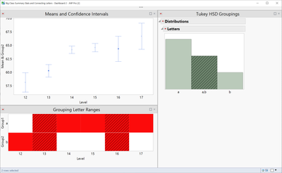

TBH, I am a scientist and I have never seen the results of an ANOVA presented this way.  i don't find the chart intuitive, and the scale is all wrong.  In ANOVA you really want the scale of the data, for visualization, to be the range of the data, or a +/- k standard deviation range around the data (k somewhere in the 2-4 range).  The plot above mostly focuses on proportional differences by showing a bar for the mean and with zero on the y-axis.
It also looks like you are using the standard deviation from each group to construct the error bars, but the Tukey-HSD used the pooled standard deviation, doesn't it?  That's what the diamonds in the Oneway plot use, also, and the width of the diamond varies because of the number of observations in the group.
I think it is better, for the plot you constructed, to stretch the Y-axis so the the focus on on the location of the mean result.
Is this just a way to get around having to explain the "circles" in the Oneway plot that are used to which groups are similar or statistically different?
How about this plot instead?
I played around with your resulting table, created two columns to indicate if the row was in group "a" or "b" and then created this dashboard.

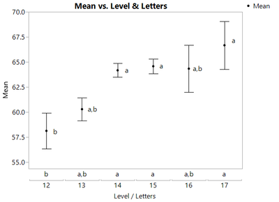

Byron_JMP
Staff
Sam,
In academic papers and research and development, this graph is very common. Other formats may be more informative, however normative wins. Here is a link to a whole raft of figure from papers published in high impact factor journal. As you can see, this figure type occurs fairly often.
Published scientific papers use this format frequently
Regarding intervals: It's definitely the 95% confidence intervals, take a look at the table that the graph is run against
