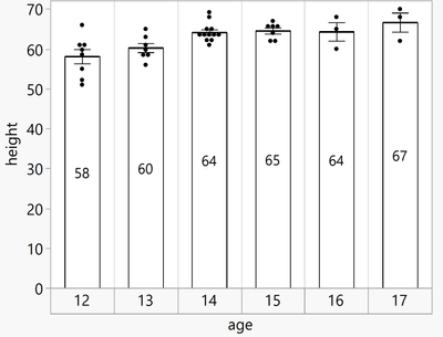

Graph builder can display value labels on bar graphs, unfortunately, if data is also plotted on the bar graph, the labels are completely obscured.
Fortunately it is relatively easy to manually reposition the labels. Getting alignment correct is a wee bit tricky, and doing this more than once is relatively frustrating.  Even editing the graph script to get alignments correct is tedious after the second or third iteration of a graph.  With a little JSL magic we can find the frames and bar segments and automatically adjust the label off sets.
In the script below an example data table is opened, and then a graph script is run, followed by some formatting instructions.
To use this script, either substitute in your data table reference or uncomment the "dt=current data table();" line to let the script run agains the current table. The graph builder script is an example, you use RTM>Save Script> to Clipboard to get your graph builder script and then paste it in place of the example.

hi @Byron_JMP , nice trick. very useful.
alternatively one could add the labels to a second bar graph element:
dt=Open( "$SAMPLE_DATA/Big Class.jmp" );
Graph Builder(
	Size( 563, 522 ),
	Summary Statistic( "Median" ),
	Graph Spacing( 4 ),
	Variables( X( :age ), Y( :height ) ),
	Elements(
		Bar( X, Y, Legend( 4 ), Error Interval( "Standard Error" ) ),
		Points( X, Y, Legend( 5 ) ),
		Bar( X, Y, Legend( 6 ), Bar Style( "Float" ), Label( "Label by Value" ) )

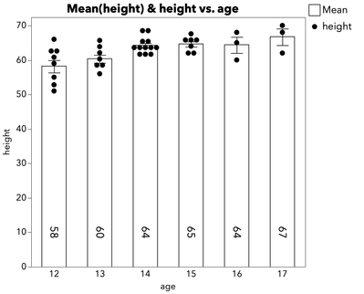

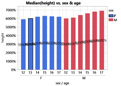

I often have a related issue: no space for horizontal labels:
Is there a workaround via JSL to rotate the labels?
Byron_JMP
Staff
It sounds like you would like to have the labels rotated like this:
I wouldn't have tried without your question.  There is some obscure JSL that lets you set the font properties AND the angle. Honestly I've never seen this done before, and it looks pretty fantastic.
The JSL is this: Set Font( "", 18, "", 90 ).  The font is "", the size is 18 points, the formatting is "", and the angle is 90. In the scripting index the example has the font specified and the formatting specified, but replacing those with, "", appears to use the default.  Changing the angle to -90 makes the text read bottom to top.
