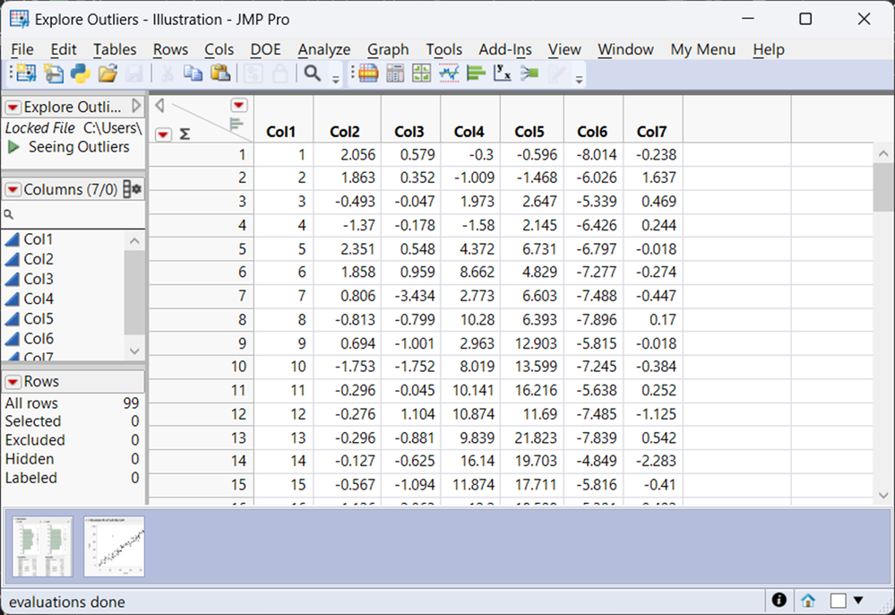

Here's a sample data table.
  • The data table contains 99 rows of simulated data
  • Data was designed to illustrate some types of outliers that are difficult to detect
Can you detect outliers in this sample data table?

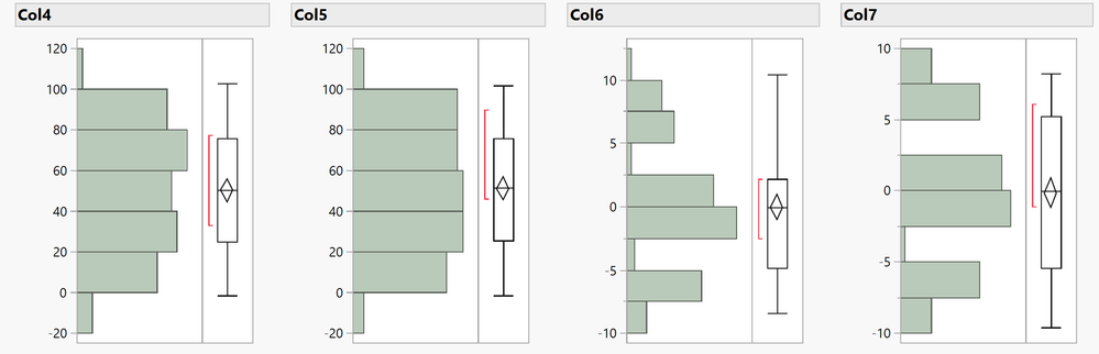

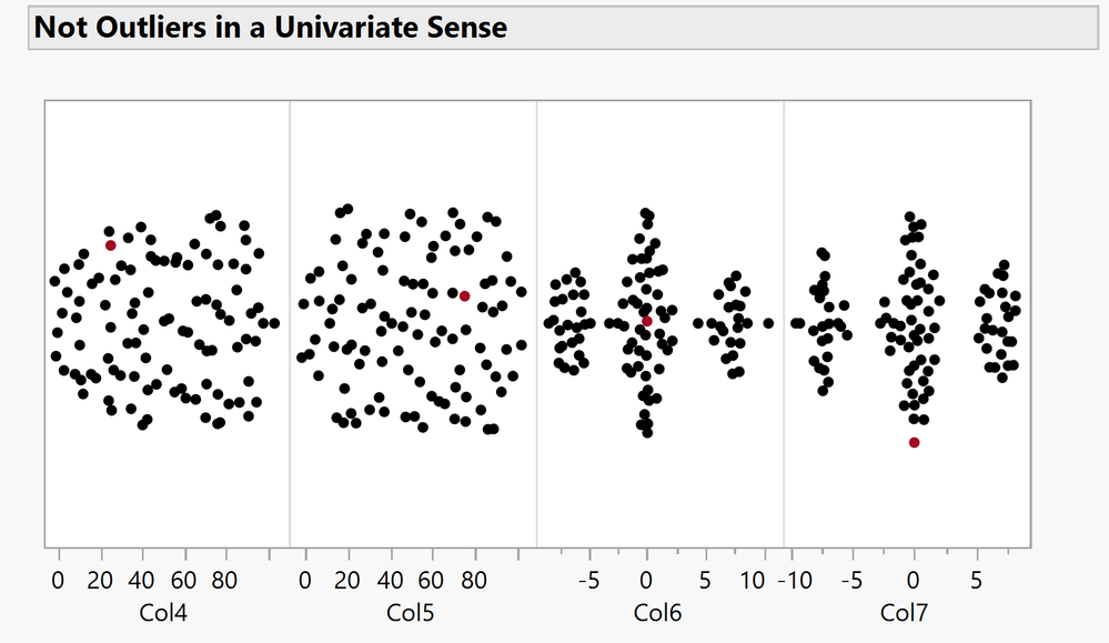

Initially, we can examine the data through a univariate approach.
We were unable to identify outliers using a univariate approach.

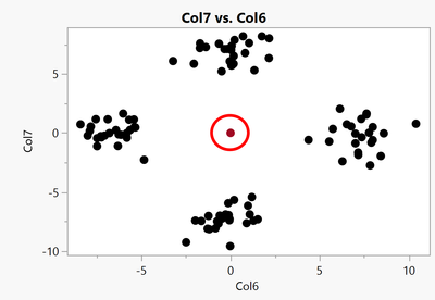

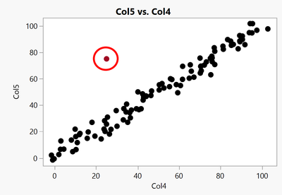

However, if we broaden our scope to two dimensions, we may encounter outliers.
DaeYun_Kim_0-1713335974481.pngDaeYun_Kim_0-1713335974481.pngDaeYun_Kim_1-1713335989387.pngDaeYun_Kim_1-1713335989387.png
The preceding scenario isn't too dire since we can identify outliers through graphical analysis.

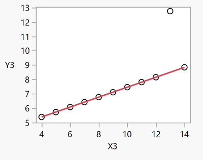

Robust Median Regression using Anscombe data table
To mitigate the impact of outliers, we can employ robust regression techniques like median regression.
Robust median regression is a statistical method that uses median regression to minimize absolute deviations and is resistant to violations of homoscedastic and normal assumptions.

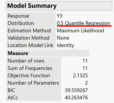

In JMP Pro, effortlessly apply median regression by selecting the "Generalized Regression" personality and opting for the "Quantile Regression" distribution, specifying the quantile as 0.5 through the Fit Model platform.
The following presents the outcome of median regression applied to the sample dataset "Anscombe" within JMP.
DaeYun_Kim_6-1713319613183.pngDaeYun_Kim_6-1713319613183.pngDaeYun_Kim_2-1713336036957.pngDaeYun_Kim_2-1713336036957.png

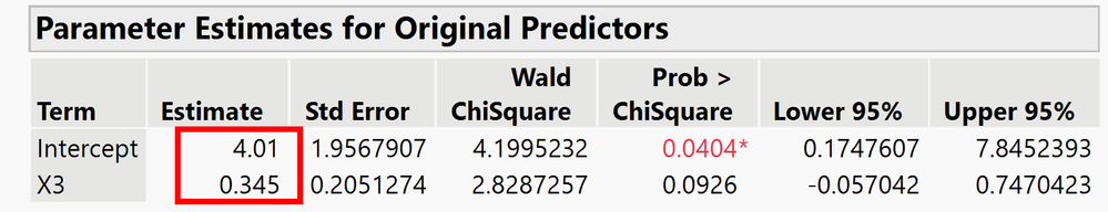

The output of beta coefficients are listed LOG windows like below.
(array([3.00245455]), array([0.49972727]))
(4.009997266957748, 0.34500026527269356)

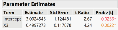

Just to let you know, the following results indicate the mean regression coefficient calculated using JMP.
You can compare the beta coefficients above for both mean and median regression.
