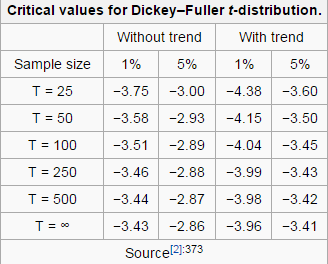

As usual in JMP, right off the bat we have some test statistics to tell us something about this data. Notice the Zero Mean ADF, Single Mean ADF and Trend ADF stats in the table to the right of the graph. ADF stands for Augmented Dickey Fuller test, which is a way to check for a unit root (a feature which changes over time) within the time series. In lamen’s terms, it’s checking for an underlying time dependent trend within the data. The three metrics correspond to checking for no underlying time component (zero mean), constant increase over time (single mean) and acceleration over time (Trend). If the statistic is below the T value found below then the null hypothesis that it is not a component can be rejected. In other words, if it’s below the T value then there is an underlying time component.

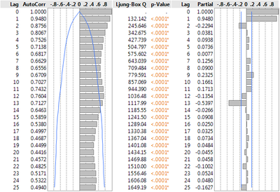

Underneath the first graph you’ll find an AutoCorrelation summary. It shows how each point is dependent on the previous points.
