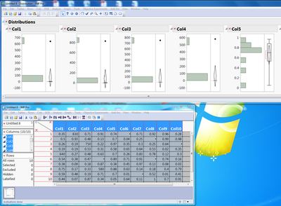

The distribution platform is a great tool for seeing abnormalities in data. Notice there are entries 1000 times greater than expected in our data set. I personally encounter data where inspectors/operators miss the decimal or even choose to omit all decimal places to be faster! It is a good idea to verify errors like this with the operators before making changes.

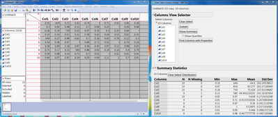

The Columns Viewer is quick and easy summary tool. The image below shows a summary table for all columns. Notice there are 10 missing values in our data. Missing values where zeros should be is a very common manual entry error, even more common than misplaced or dropped decimals in my experience. This may seem trivial with our small table where we can easily see all of the missing values. But, imagine the difficulty if our data set has thousands or even millions of rows of data! Haystacks and needles come to mind.
Summary statistics can be used in the same way we used the distribution platform above. Notice max values for col1-col4 are 100 times greater than expected –same as we learned in distribution.

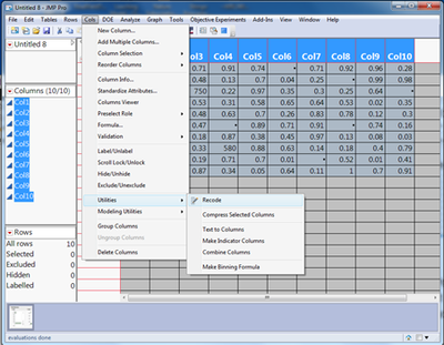

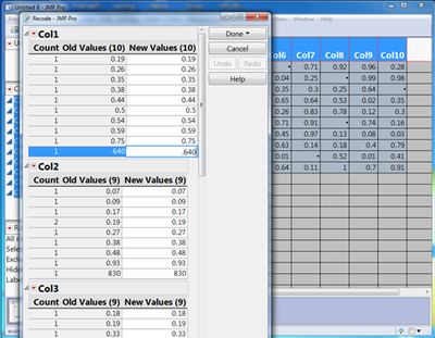

The Recode Utility in JMP provides a menu driven option for changing values in a data table. Columns must be selected in order to access the utility. Both of our errors can be fixed in recode.

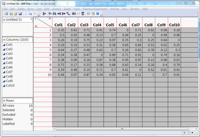

Take a look at the results! We fixed both the missing decimal and missing zeros with 2 lines of code and no loops! Take note that to avoid loops I generated a new data table with correct values.  If you want to keep an existing table then a loop is needed to assign values to each column in the data table.  I will let you all experiment with this on your own.
This is what happened.  Loc(rndMat>100) is a matrix of indices in rndMat where values are greater than 100. rndMat[Loc(rndMat>100)] = rndMat[Loc(rndMat>100)]:\1000 replaces the values at these indices with the current value divided by 1000.  Replacing missing values is simpler as we are just replacing missing values with zero.
