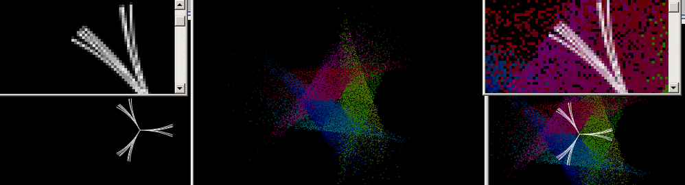

The example above is the typical way the alpha channel is used. The example below is a variation. The JSL is drawing the color with the RGB values and drawing the white (or black) lines with the alpha value. There are other ways to get the same effect, but this way didn't need extra code to merge the data. The color of the line is determined by the background color of the border box that holds the image box. When the alpha value is 0, the background shows. In the render function, two arrays, bitcolor and bitcurve, are combined to make the image. bitcurve is built with 1.0 where the line should appear, so 1-bitcurve makes the alpha channel that is needed.
	{red,green,blue} = colortorgb(bitcolor);
	image=newimage("rgba",{red,green,blue,1-bitcurve});
Changing the results from white line on black background to black line on white background is done by changing the border box color.
newwindow("curves",bb=borderbox(textbox("")));
bb<<setbackgroundcolor(linecolor);
The border box is created with a dummy textbox child which gets replaced by the first image.
	(bb<<child)<<delete;
	bb<<append(image);
Bitcurve on the left, bitcolor in center, RGBA on right. In this image, the RGB data is mostly black and the white background shows through where the alpha channel is > 0.0.
Border box with a white backgroundBorder box with a white background
In this image, the RGB data is mostly white, and the black background shows through instead.
Border box with a black backgroundBorder box with a black background
In both images above, the right side shows the alpha blending of the colors over the border box's background color.
