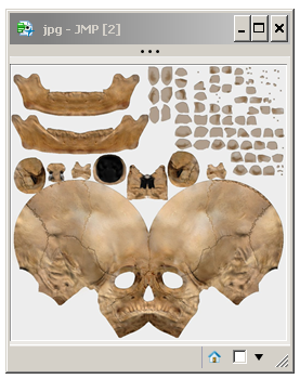

That's three files and a directory to hold them. I'm not sure what the .mtl file does, and this post is mostly about the .obj file. The .jpg is really interesting, and it gets used later, and looks like this:
jpgblob=za<<read(members[2],format("blob"));
img=open(jpgblob,"jpg");
img<<scale(.25);
newwindow("jpg",img);
Texture map for skull, 1/4 sizeTexture map for skull, 1/4 size

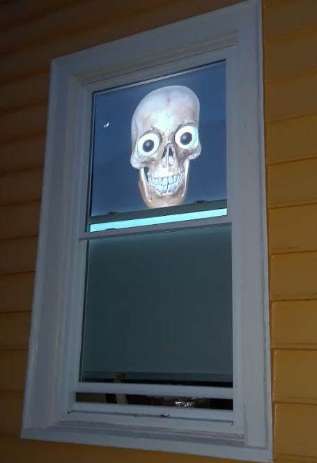

Halloween early evening, model in windowHalloween early evening, model in window
Does it look like the eyes are following the photographer? What's with the gap at the bottom of the window?

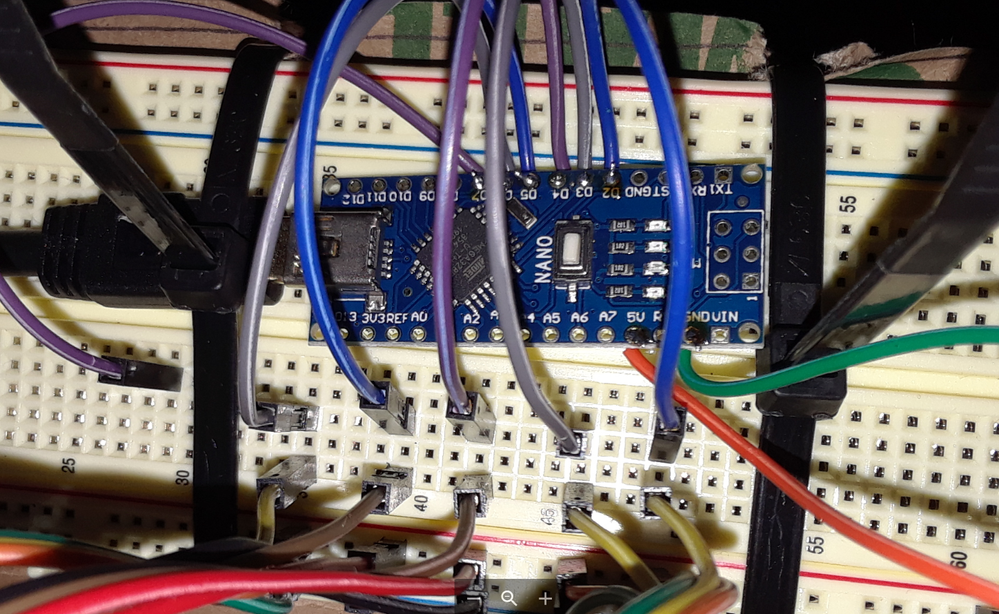

Arduino Nano and PIR sensors

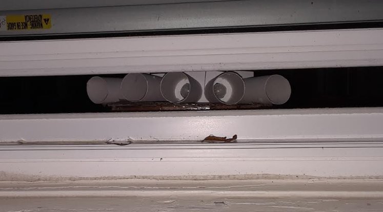

To make the eyes track people, some sort of sensor is needed. PIR sensors have a single-bit interface (something moved!) and some limitations on response time. Given the low turnout on Halloween, they were the right choice. A Raspberry PI camera could provide better performance. The gap below the window allows five PIR sensors with collimators to watch regions where people might walk. Here's the setup:
They do like like eyes. Those collimator tubes are re-purposed.They do like like eyes. Those collimator tubes are re-purposed.

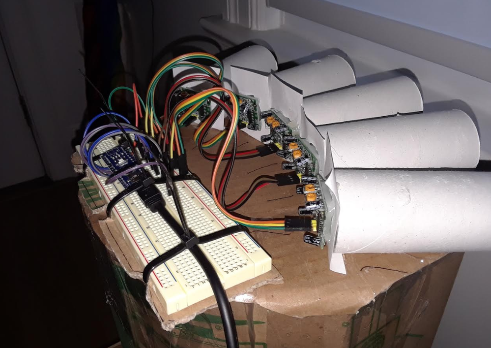

And here's what the assembley looks like, taped, hot-glued, and jumper-wired to the Arduino Nano. The Nano is small.
Arduino Nano on left under zip-ties. PIR sensors on right hot-glued to collimators. There are two orange adjustments on each PIR.Arduino Nano on left under zip-ties. PIR sensors on right hot-glued to collimators. There are two orange adjustments on each PIR.
The Nano clone came with header pins that can be soldered on, or wires can be soldered to the Nano. Cutting jumper wires in half and soldering one end makes it a little less likely to fall apart and a little more likely to be reused in another project.
Nano has wires soldered on, orange is +5, green is ground, purple/gray/blue are data linesNano has wires soldered on, orange is +5, green is ground, purple/gray/blue are data lines

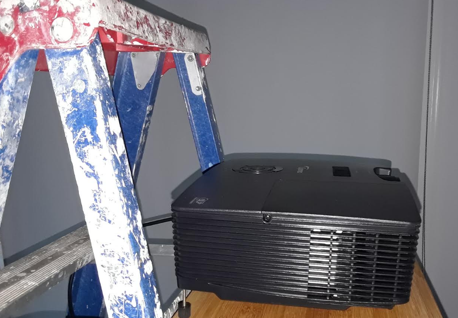

And that projector is bright! Here's the special projector stand, projecting onto a translucent window shade:
Not recommended if you have a cat.Not recommended if you have a cat.
