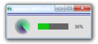

Re: Does JSL provide a "busy" indicator similar to a spinning wheel or bar?
here's an example of a progress indicator made in JSL; it uses a namespace to encapsulate the code.  The last few lines are a test, try setting workload ​bigger or smaller.  For smooth performance the progress:set function must be called fairly often. The progress:init function needs to know the total amount of work that will be done to get the percentage right.
Edit: attached a copy of the JSL, apparently the inline JSL may not display correctly.

// test
workload = 1e6; // 1e6 is about 5 seconds
progress:init( workload );
For( i = 1, i <= workload, i++,
	progress:set( i )
progress:term();
