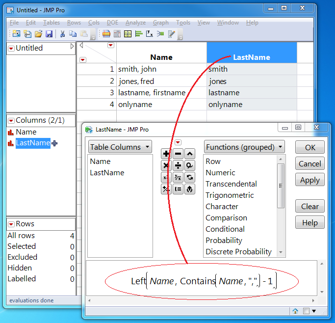

Example
Data table column formulas can compute a value from another column. Here's a "last name, first name" example that assumes the comma is a unique delimiter. This example works for the "onlyname" case because of the way Left interprets any out-of-range length as everything. Look for the Regex post, you might like it better.
Column formula using Left() and Contains()Column formula using Left() and Contains()
Column formula using substr() and contains()Column formula using substr() and contains()
