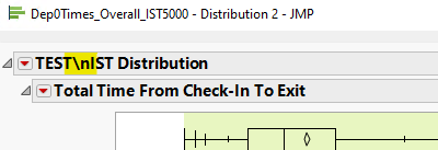

Dear Community,
Now that we reached a nice Application, we would like to customize charts Titles and add som Text Annotations, like Project & Scenario name, Description...
To make it nicer, I tried to insert a Line Feed control code into the string but it is displayed instead:
	SendToReport(
		Dispatch(
			"Distributions",
			OutlineBox,
			{Set Title( Eval( Char ( scenario ) ) || "\nIST Distribution" )}
In idea if this is even feasible?
Thanks

The escape sequence for new line is "\!n"

Thanks a lot Jim, it worked fine!
