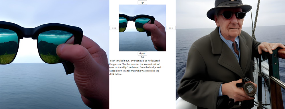

In addition to the paragraph text, there is an audio and pict column. The audio column has a click handler to play the binary data. This is the denouement of1729 paragraphs.In addition to the paragraph text, there is an audio and pict column. The audio column has a click handler to play the binary data. This is the denouement of1729 paragraphs.Before looking at the code to make pictures, let's dive into paragraphToSamples to see the first New HTTP Request. The first function, getSamples, shows the logic for the New HTTP Request that performs a GET on the TTS (text to speech) server. The second function, paragraphToSamples, splits a paragraph into segments for the voices, uses getSamples for each segment, and joins the samples together for the paragraph. The New HTTP Request uses the fields to package the speaker name and text into an HTML GET request to a server running on a local computer (Python, below.)

When that is all done, there may be several data tables of images to combine into a single table. I used a bit of JSL to help me click through 1729 pairs of images to remove objectionable or choose the best.
// interactive picture selection
dt = open("f://redwindows/story.jmp");
dta = open("f://redwindows/pic1024A.jmp");
dtb = open("f://redwindows/pic1024B.jmp");
if(nrows(dt) !=1729 |nrows(dtA) !=1729 |nrows(dtB) !=1729, throw("rows") );
irow=1;
newwindow("chooser",
	hlistbox(
		vlistbox(abox=mousebox(textbox())),
		vlistbox(spacerbox(size(300,1)),
			hcenterbox(buttons=vlistbox(
				hcenterbox(buttonbox("up",irow=max(1,irow-1);updateRow())),
				hcenterbox(hlistbox(
					vcenterbox(buttonbox("==>",dt:pict[irow]=dtA:pict[irow];updateRow())),
					cbox=mousebox(textbox()),
					vcenterbox(buttonbox("<==",dt:pict[irow]=dtB:pict[irow];updateRow()))
				hcenterbox(buttonbox("down",irow=min(nrows(dt),irow+1);updateRow()))
			hcenterbox(rbox = textbox()),
			tbox=textbox()
		vlistbox(bbox=mousebox(textbox()))
abox<<setClickEnable( 1 );
abox<<setClick( Function( {this, clickpt, event}, if(event == "Pressed",dt:pict[irow]=dtA:pict[irow];updateRow());if(event == "Released",irow=min(nrows(dt),irow+1);updateRow())));
bbox<<setClickEnable( 1 );
bbox<<setClick( Function( {this, clickpt, event}, if(event == "Pressed",dt:pict[irow]=dtB:pict[irow];updateRow());if(event == "Released",irow=min(nrows(dt),irow+1);updateRow())));
cbox<<setClickEnable( 1 );
cbox<<setClick( Function( {this, clickpt, event}, if(event == "Pressed",irow=min(nrows(dt),irow+1);updateRow())));
updateRow = function({},
(abox<<child)<<delete;
apic=newimage(dtA:pict[irow]);
apic<<scale(.35);
abox<<append(apic);
(bbox<<child)<<delete;
bpic=newimage(dtB:pict[irow]);
bpic<<scale(.35);
bbox<<append(bpic);
(cbox<<child)<<delete;
if("Picture"!=type(dt:pict[irow]),dt:pict[irow]=dtA:pict[irow]);
cpic=newimage(dt:pict[irow]);
cpic<<scale(.15);
cbox<<append(cpic);
rbox<<settext(char(irow));
tbox<<settext(dt:paragraph[irow]);
updateRow();
The middle image is the one I chose for this paragraph, the least bad.The middle image is the one I chose for this paragraph, the least bad.
