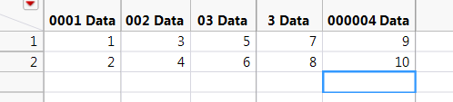

Community Trekker
@gianpaolo_polsi ,
 Here is one way to address .My suggestion is to post such questions in "Discussions" - and provide a link the blog. The community will be able to address your question faster :

Provided is a screenshot of data table (dt) I made for running the example
