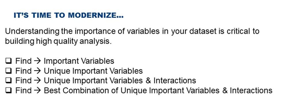

See how to use simple statistical techniques help identify important variables and interactions in your data as a precursor to building high performing prediction models and uncovering additional insights.
See how to:
Understand prerequisites to consider before starting to ID important variables
Clean-up and prepare data using Column Viewer
ID and decide how to handle outliers and missing data using Explore Missing Values, Explore Outliers and Explore Patterns
Ensure dataset is the best representation of the system you plan to study<
Use Distributions in Column headers and Graph Builder to explore the data and visualize trends
Perform Multivariate Analysis to ID correlated variables
Use Response Screening to ID the most important variables that affect the response
Use Predictor Screening (decision tree methods) to test many factors in predicting a response
Use Multivariate Analysis to ID variables with high correlation
Cluster variables to group correlated variables together and identifies the single variable that is most representative
Use Fit Model>Response Screening and Stepwise Regression to find interactions and higher-order terms based on your important and unique variables
