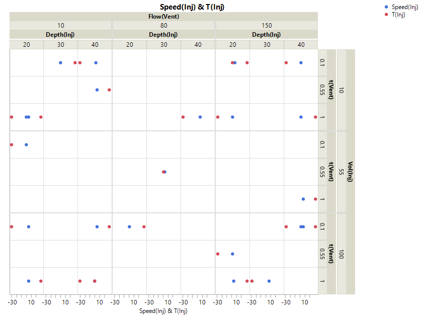

One thing I was wondering, if it would be possible for you to provide the table of the 4,374 runs? I want to practice making that factor plot that you made in graph builder, so that I can appreciate more the complexity of the full factorial design versus the geometrically reduced factor space offered by the DSD design.

Thanks for your kind feedback, @PatrickGiuliano. I have attached the 4374-run full factorial. The table includes simulated results and scripts for various visuals and analyses. I hope they are helpful. Please let me know if I can do anything else to help.
