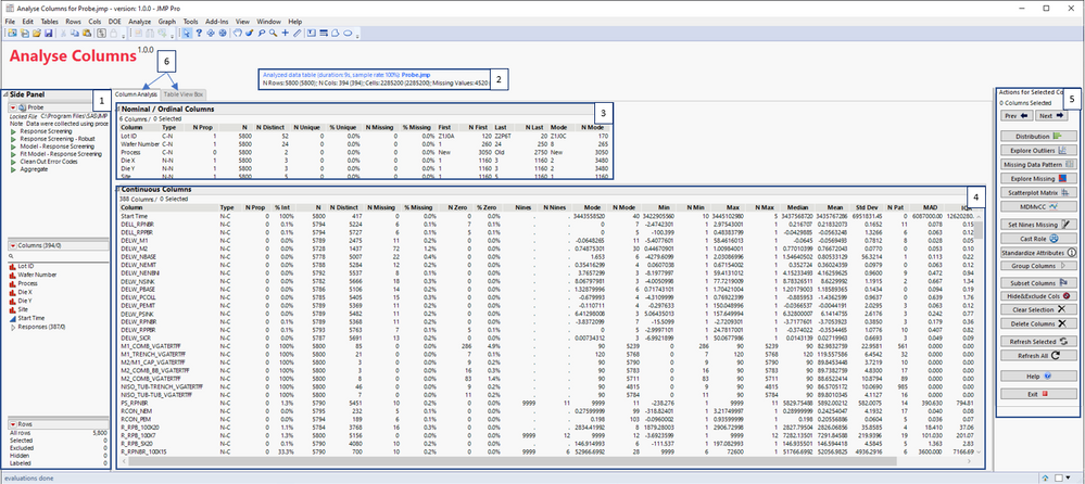

Analyse Columns
Analyse columns is a tool which will perform fairly quick pre-determined summary statistics (explained below) for your discrete (nominal/ordinal) and continuous data

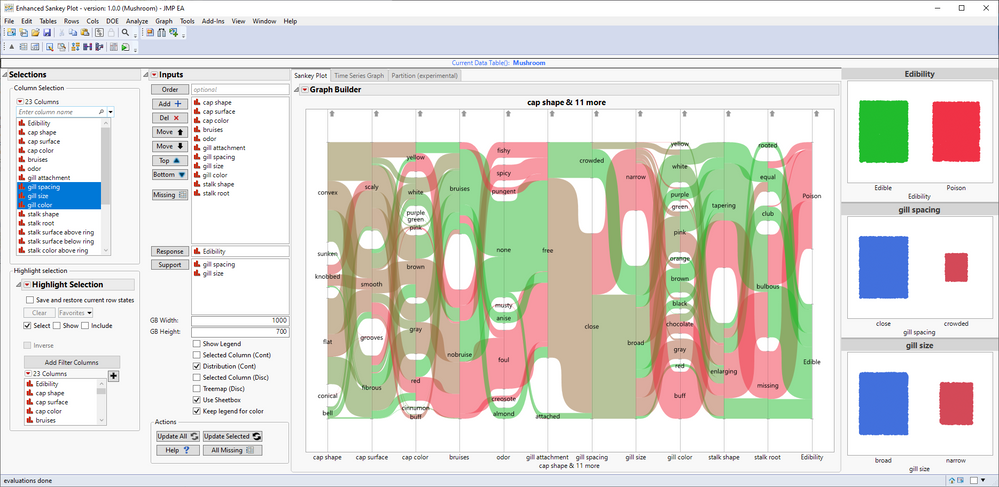

Enhanced Sankey Plot (ESP)
This add-in provides easy to change X-axis for parallel plot found from Graph Builder which creates one more EDA (Exploratory Data Analysis) tool for JMP which is fairly easy to use and interactive.

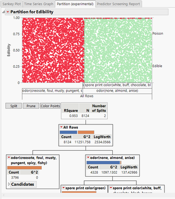

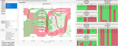

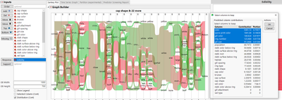

Based on the feedback received in the meeting, I have added Predictor Screening behind Auto-Order button
Start when Auto-Order is pressed:
Result after some additional selections done:

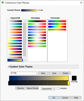

@jpol @jpol, curious where to find the IBM colour palette that was used during the presentation of the Sankey plot. As a personal follow-up, I have now changed to a different JMP palette, am consequently away from green and red but not quite happy due to "sallowness" (tyyneyttä? ... I had to look that word up in both languages).
P.s.: May ask a follow-up question, how to get a different palette into JMP, later on.

Hi @Ressel, I'm not sure where @jpol has found the palette or if the has built it himself from somewhere like Coloring for Colorblindness (davidmathlogic.com) (seems like very nice page for building color palettes). This might work (just built it):
Add Color Theme({"IBM", 2051,
	{{100, 143, 255},
	{120, 94, 240},
	{220, 38, 127},
	{254, 97, 0},
	{255, 176, 0},
	Missing({64, 176, 166})}
I personally like Cividis which I found from jmp community: https://community.jmp.com/t5/Discussions/colorblind-safe-palette-JMP-13/m-p/55181/highlight/true#M31...
And from time to time I use something like this Seaborn-Inspired Modern Styling

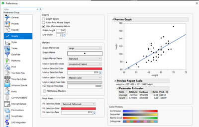

You can use JSL to set the color preference or you can use preferences menu
