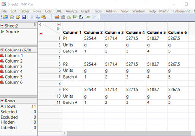

Today I want to talk about a second scenario, which is a bit more complicated. I see this case quite often when looking at customer’s data coming from e.g. labs. The horizontal structured data table:
That is first row/first column is the parameter name, in the following columns is the data. In the second row are the units, in the third row the batch number. Then an empty row and after that the same thing again for another parameter. This is easier to read in a spreadsheet but eventually not very easy to analyze. I often see these kinds of data, although it would be much better to train people to enter data in the vertical way than trying to work around with the horizontal structure.
How can you import and update a table like this in JMP? What’s so difficult with that data?
We have to understand the challenges.
  • First, the data is arranged in rows, but more a challenge is that there are multiple rows showing similar information. Parameters (P1, P2, P3), Units and same Batch number repeated for each parameter
  • Second, we have empty rows to divide the data for easier interpretation what belongs to what
For a data analysis this kind of structure is nothing a machine would love, you would need to specifically tell where what data is located and do the appropriate analysis. If new data is added to the right, you need to adjust the analysis’ data ranges appropriately.

1.   Access the current data from the spreadsheet as it is:

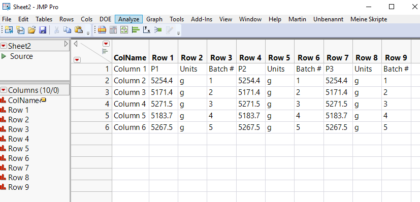

3.    The first column has the actual column names we want to have in the final data. We want to save them for later usage. Then we can transpose the table, provide it the final table name (as the worksheet – as I will refer to the table name to automatically find the corresponding worksheet in the spreadsheet):
// Get names used for column names after transposing the data table
NewNames = dt_h1:Column 1 << Get Values;
// Transpose Column
dt_final = Data Table( name_worksheet || "help" ) << Transpose(
	columns( 1 :: N Cols( dt_h1 ) ),
	Label column name( "ColName" ),
	Output Table( name_worksheet )
4.   We now need to make some changes to the data table:
    • Remove the first column
    • Remove the first row
    • Change the column names
    • And finally set the correct data and modeling types (due to the first row all has been set to character), and save the file
    • For this example also remove the last two rows so we can test the update script without adding columns to the spreadsheet
  • Note: based on your system’s localization settings as well the Office language you might need to take care of the preference settings in JMP or the decimals/commas first (e.g. with recode) before changing the data and modeling type
The final table should look like this:

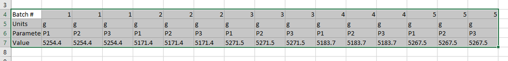

To provide two examples which would ease the analysis:
  • Note: adding a new column for the Parameter name removes the burden of rearranging the imported data. And you have a grouping variable you could use as an overlay or by group in the analysis platforms. This avoids running the same analysis for each column, but does it at once.
