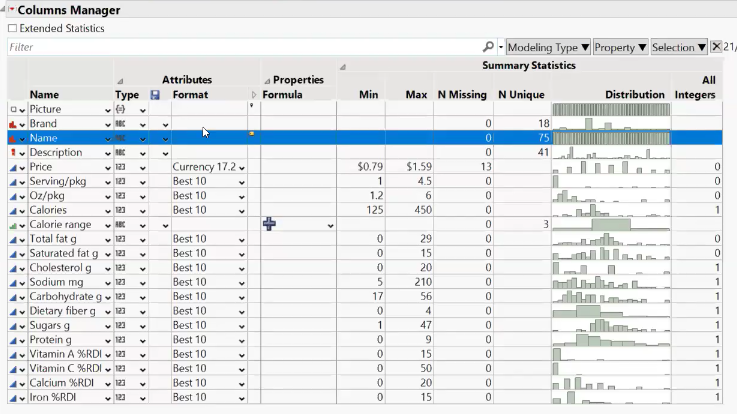

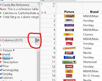

Invoking the Columns ManagerInvoking the Columns Manager
Using the Columns Manager to view and edit column informationUsing the Columns Manager to view and edit column information

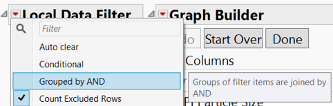

Q: On the data filter in Graph Builder, how does it handle Boolean ‘ands’ and ‘ors’? How would I do equals A AND (X OR Y)?
A: There are several ways.  One way is to use Grouped by AND" under the Local Data Filter red triangle.  another way is shown in the video below.
