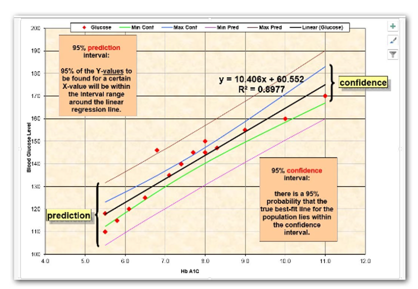

        Patrick Guiliano @PatrickGiuliano , JMP Technical Support sent this information after the webinar:
        The following commentary came from another JMP user. The "Confidence" lines (see image) are slightly curved, and define a 2-dimensional space in which we claim the true linear regression line exists; that is, if we imagine that the observed linear regression line can rotate about the point that is Xavg, Yavg but only within that space (i.e., the rotating line has to stay completely within the confidence lines),  then the true parameter slope of the line is said to be somewhere between the largest and smallest slope possible by performing such rotations, at a confidence level = to whatever confidence value we used to calculate those confidence lines. The confidence lines can therefore be used to predict the worst-case scenario for an AVG Y-value at a SPECIFIC X value.
        The Prediction interval lines are also slightly curved; they define a 2-dimensional space in which we PREDICT the next single X,Y-value we obtain will occur. Our prediction is more confident, the closer we are to the Xavg,Yavg point, and is less confident the further away we are, which is why the lines looked curved.
