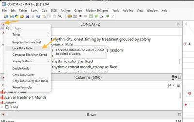

Q: What is a locked table?
A: JMP Tech Support @PatrickGiuliano Patrick Giuliano responded:  A table can be locked because the user locks it as shown below. It could be locked for other reasons. A table can also be "Locked File" because you are trying to edit a file saved in a read-only file directory location. In the video, the presenter was working from JMP sample data files and that installation directory is typically set to read-only, so he had to save as another filename.
