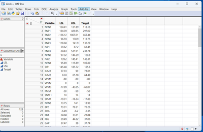

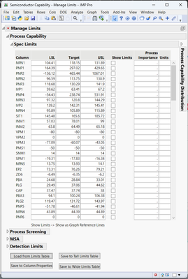

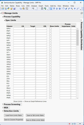

Q: For very large datasets, is there a way to set spec limits for all columns? Can spec limits be imported from an external file/table?
A: This is a good way to approach it: Analyze > Quality and Process > Manage Limits > Select the columns and click Process Variables > OK > Load from Limits Table > Choose the table that has the limits > OK
