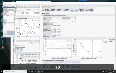

  • Reveal all JMP Windows. On Windows, you can reveal all JMP windows by pressing F9. This will make it easy to find exactly the window you want.
    On Windows, F9 reveals all JMP windows.On Windows, F9 reveals all JMP windows.

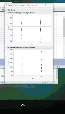

Sometimes you'd like to combine two reports into a single window for ease of analysis or to create something like a dashboard for someone else when you pass a data table to them. Application Builder and Dashboards make this pretty easy. Start by arranging the report windows on the screen as you'd like them, side-by-side or top-bottom.
From here the method is different between Windows and Macintosh.
Windows
Click the checkbox in the lower right of each window. Then click the drop-down menu next to that checkbox on one of the windows and choose Combine Selected Windows.
Alternatively, you can select the windows in the list in the Home Window (click on the first one and shift/ctrl-click on others) and then right click and choose Combine.
Macintosh
Choose Window -> Combine Windows... from the menu bar and you'll get a list of windows to choose from. Select the ones you want and click Okay.
Once you've got your new report window use the hotspot menu at the top to save a script to the data table – or elsewhere if you like. You can also edit the application using the Application Builder to get finer control of the placement and grouping of the report elements.
