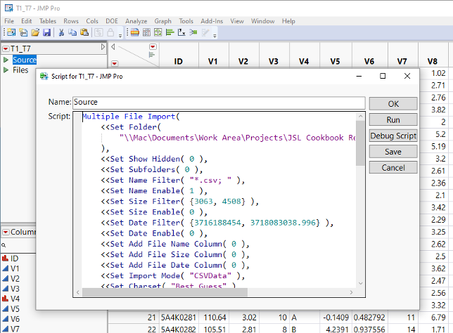

  1. Using File > Import Multiple Files, navigate to the directory that contains the files. Click the button at the top right to get the dialog allowing directory navigation and selection. DonMcCormack_1-1643397967579.png Check the first filter and select or type in CSV. The resulting list will grey the files not matching the filters. We won’t be able to select individual files here, it’s all or nothing.
  2. Expose the code by right clicking the Source table variable in the resulting table and selecting Edit. Copy it to a script window.DonMcCormack_2-1643398006645.png
  3. We will add a variable reference to access the resulting table and change two of the function arguments. The top of the function should look similar to this:
    dtFinalTbl = Multiple File Import(
       <<Set Folder(mainFolder),
       <<Set Show Hidden( 0 ),
       <<Set Subfolders( 0 ),
       <<Set Name Filter( fileList),
    Only the first and fourth arguments have been changed, the hard coded string values are replaced with variables.

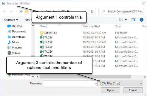

  4. We will use the Pick File function for user input. It has 7 arguments, all optional. We want to specify the user prompt text (1), selectable file types (3), and allow the user to choose multiple files (7). We need to use the default values for the other arguments to get the function to work properly. Everything can go on one line, but it’s shown like this, so the arguments stand out.
    csvFiles = Pick File(
       "Select the CSV files: ",
       {"CSV Files|csv"},
       1 ,
       0 ,
       Multiple

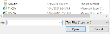

    Argument 3 is a list with one or more strings taking the format:
    fileTypeText | fileTypeExtension
    fileTypeText only effects Windows (but is still required to be supplied for Macs). It supplies the text shown in the combo box at the lower right that filters the file types. fileTypeExtension specifies the extensions of the selectable file types in the dialog.
    {"Text Files|csv;txt"&#125;{"Text Files|csv;txt"}
    {"Text Files|csv;txt","Excel Files|xlsx","ASCII files|asc"&#125;{"Text Files|csv;txt","Excel Files|xlsx","ASCII files|asc"}
