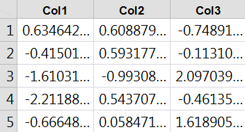

You have data in a Matrix and need a Data Table, or the other way 'round
Data table or matrix?Data table or matrix?
Solution
There is a function, AsTable(), that makes a new data table from a matrix, and a data table method, GetAsMatrix(), that makes a matrix from the numeric columns in a table.
There is also a way to index data tables directly with data table subscripting.

dt = As Table( mat );
// make a matrix from a data table
mat2 = dt << GetAsMatrix;

 Data table subscripting describes indexing a data table as a matrix, and What is the JSL Matrix? shows how to use matrix subscripting. So, with a data table (or a matrix), rather than copying the data out of the table to make a matrix, you can get a row from either one like this:
// if dt is a table...
rowVector = dt[ rowNumber, 0 ]; // all columns
rowVector = dt[ rowNumber, { age, height, weight } ]; // selected columns
// if m is a matrix
rowVector = m[ row, 0 ];
rowVector = m[ row, 5::9 ]; // selected items from row
// and both dimensions at once
patch = m[ 3::5, 7::11 ];
The zero subscript means "all of this dimension". The matrix indexing starts at one.
