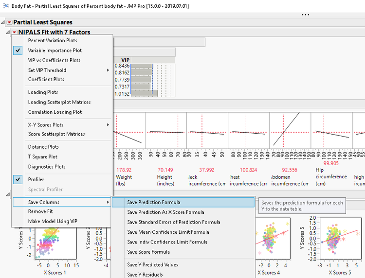

If you get this message in the log, there may be a workaround. For many platforms that have a Profiler, the red triangle menu will provide a "Save Columns" submenu with "Save Prediction Formula" as an option:Demonstrating the Save Prediction Formula option in the Partial Least Squares platform.Demonstrating the Save Prediction Formula option in the Partial Least Squares platform.

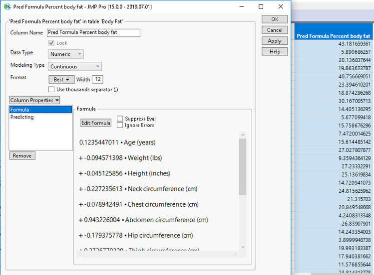

Using the Body Fat sample data set, run the "Partial Least Squares" script and add the Profiler from the red triangle menu for "NIPALS Fit with 7 Factors". If you were to export this, you would get a static image -- we haven't gotten to enhancing the Partial Least Squares platform yet to export the Profiler to Interactive HTML. However, if you go to that same red triangle menu and select Save Columns > Save Prediction Formula, it will create a new column "Pred Formula Percent body fat".Prediction column saved to the data table.  By viewing the column's properties you can see the formula of the profiler.Prediction column saved to the data table. By viewing the column's properties you can see the formula of the profiler.If you view the Column Properties, you can see there is nothing complex about this formula -- simple multiplication and addition. If you open up the Graph > Profiler menu and add this column for Y, you get a standalone Profiler that does export to Interactive HTML or JMP Live. Because of the number of factors, I chose to go to the red triangle menu and make use of the Arrange in Rows feature (found under the Appearance submenu) to make the Profiler wrap into two rows with a value of 7.
