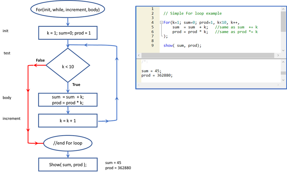

Wash, rinse, repeat is an English language idiom that might imply "do it again," or humorously imply an infinite loop. Repetition of a function or a set of steps in the context of scripting is called iteration or looping. Iteration is a very important scripting technique. Below is the logic diagram and corresponding JSL code of a simple For loop.
