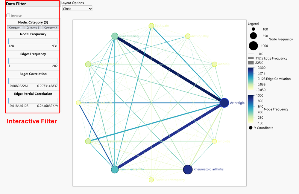

The plot is fully interactive; users can dynamically filter the underlying data using options in the left-side panel’s Data Filter, instantly updating the network to focus on specific subgroups, frequency, or correlation ranges. Selecting a node or edge in the plot highlights the corresponding records in the JMP data table, facilitating rapid drill-down for detailed review.
Figure 2. Interactive Data Filter of Network Plot add-in

To demonstrate the practical impact of network plots, we applied it to a data set of musculoskeletal adverse events (AEs) using the interactive Network Plot add-in. Each node in the network represents a distinct AE – such as arthralgia, joint swelling, or musculoskeletal pain. The edges indicate instances where these events co-occurred in patient records at least once, which happens to be all the events in this data. Node size reflects how frequently each event appears, while edge thickness and color encode the frequency or statistical strength of co-occurrence between pairs of events. Analysts can filter edges below a threshold, apply grouping filters, and instantly explore a specific subpopulation. Network plots can also complement other approaches, such as upset plots (as discussed in the post), which enumerate discrete set intersections.
Findings
With both network layouts (eigenvector-based and circle), a few patterns emerge. Arthralgia stands out as a central hub node, marked by both a large node size and thick edges connecting it to several other AEs – most notably joint swelling and pain in extremity. The prominence of these connections suggests that patients experiencing arthralgia often report joint swelling and extremity pain as well, forming a tightly knit cluster of related symptoms. This visual triad not only reflects clinically plausible associations but also highlights potential syndromic groupings that might benefit from joint monitoring or further study.
The right-side color legend and varying edge thickness communicate which AE pairs are most observed together. For example, the thick, dark blue line between arthralgia and joint swelling indicates a high co-occurrence frequency, while lighter, thinner lines such as those linking psoriatic arthropathy to other nodes indicate weaker or less common overlaps.
Nodes colored by group further divide the events, allowing for rapid visual subgrouping. For instance, Category 1 (blue) and Category 3 (green) nodes tend to cluster together, which could correspond to clinical subtypes. The interactive filters on the left panel make it possible to instantly focus on specific event categories, frequencies, or correlation levels. For example, by filtering out low-frequency edges, core patterns were clarified without sacrificing interpretability. This feature supports targeted analyses, such as isolating rare but severe event combinations or focusing on patient subpopulations most at risk.
Switching between the circle and eigenvector layouts repositions the nodes, making structural relationships more or less apparent depending on the analytic question. The eigenvector layout brings tightly associated symptoms into close proximity, emphasizing their statistical “closeness” and helping reveal groupings that might be missed in static tabular summaries. The interactive data filter allows the analyst to restrict the plot to AEs above a certain frequency or only include edges with high correlation, removing noise and enabling a clear focus on clinically meaningful patterns.
