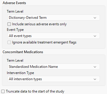

The dialog for Co-occurrence is shown in Figure 1. Users can refer to AEs or medications according to their individual coded names as specified by MedDRA or WHODrug Global, or they can refer to terms according to their reported text or higher level classification (e.g., High Level Term or Original Category for Medication). These designations become the “Terms of Interest” that are assessed for overlap by Co-occurrence. Users can opt to explore all AEs or medications or subset to terms that occur during specific periods of the study (i.e., Pre-Treatment, On Treatment, Off Treatment Follow-up, Treatment Emergent).
The option Truncate data to the start of the study is a way to limit data, particularly for medications that have been used chronically for many years, to the days after each patient has begun the study. The presence of numerous medications that have been taken for many years can affect performance, but it also assesses some overlap for a period that may be less relevant to the current trial.
Figure 1. Co-occurrence dialog

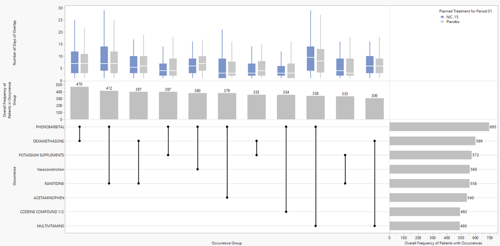

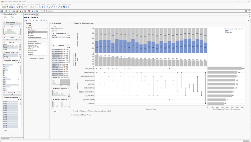

Running the report for the Nicardipine study provides the following output in Figure 2.
Figure 2. Nicardipine example
The primary output consists of an UpSet plot which has several important areas of focus. UpSet plots are used to communicate the frequency of subgroups produced according to one or more factors compared to the marginal frequencies of considering each factor alone. The vertical and horizontal axes are ordered according to these frequencies so that the further right (or down) in the plot, the smaller the frequency.
  1. The line and dots area of the figure illustrate the connections between Terms of Interest along the Occurrence vertical axis and the Occurrence Group horizontal axis.
  2. The bar chart in the Overall Frequency of Patients in Occurrence Group vertical axis and Occurrence Group horizontal axis presents the frequency of each Occurrence Group, which for now is limited to pairs of occurrences. This bar chart is presented in decreasing frequency, left to right.
  3. The bar chart in the Occurrence vertical axis and the Overall Frequency of Patients with Occurrences horizontal axis presents the frequency of each Occurrence individually. This bar chart is presented in decreasing frequency, top to bottom.
  4. The top area of the figure, within the Proportion of Treatment vertical axis and the Occurrence horizontal axis is a stacked bar chart, which shows the proportion of Occurrence Group pairs that are attributable to a particular treatment. This part of the graph has numerous additional options that are discussed further below.
For example, phenobarbital and dexamethasone are the left-most pair of terms, indicating that they occur with the greatest frequency (n=470) among all possible pairs of terms. This overlap in Terms of Interest can be compared to the individual marginal frequencies of phenobarbital (n=695) and dexamethasone (n=599). In other words, 695-470=225 patients had phenobarbital with no overlapping dexamethasone, while 599-470=129 patients had dexamethasone with no overlapping phenobarbital. The underlined text highlights a very important distinction about the Co-occurrence report, which specifically looks for pairs of Terms of Interest overlapping in time within patients. A patient could take both phenobarbital and dexamethasone, but if there is no overlap on the same study days, it is not counted toward the 470 patients with phenobarbital and dexamethasone.

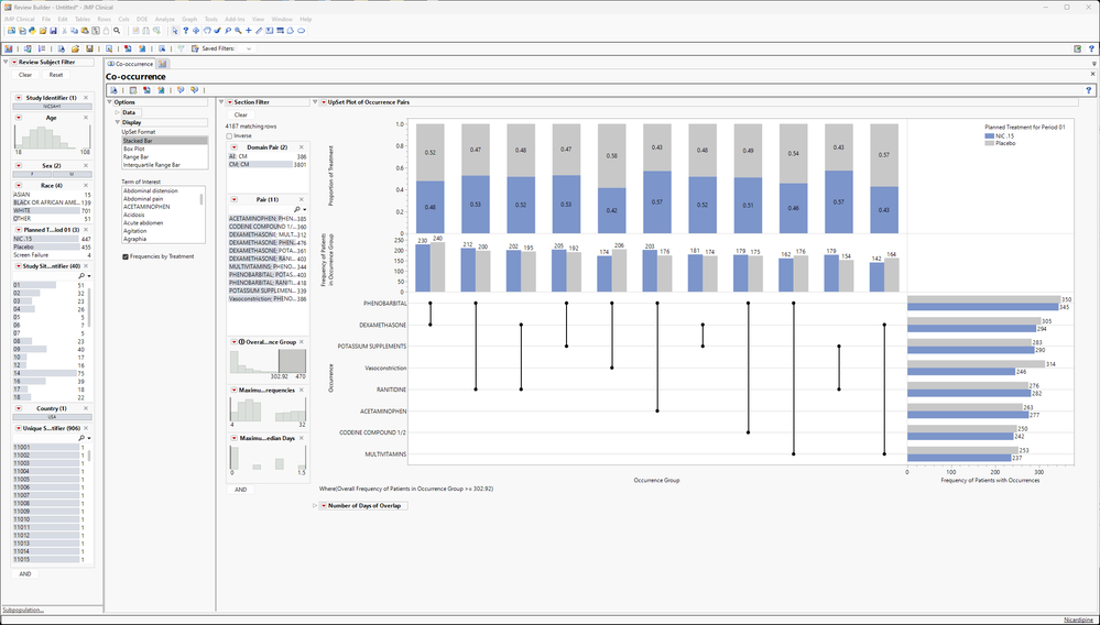

Of these 470 pairs, 48% and 52% of them occur within patients on Nicardipine or Placebo, respectively. Marginal counts for each treatment are visible in the data table, or the user can click Frequencies by Treatment in the Display Options area to change the bar charts to side-by-side bar charts with sample sizes for each treatment (Figure 3). Although filtering may be needed to view treatment-specific sample sizes, we can observe that 230 and 240 patients on Nicardipine or Placebo, respectively, had the “Dexamethasone, Phenobarbital” pair.
Figure 3. Frequencies by treatment

  1. Box Plot: Produces side-by-side box plots summarizing the Number of Days of Overlap for Occurrence Groups (Figure 4).

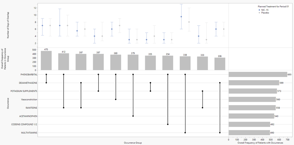

  2. Range Bar: Produces a range bar plot, formatted to appear like a confidence interval, that summarizes the median value as a symbol with low and high interval values represented by the minimum and maximum observed values, respectively (Figure 5).

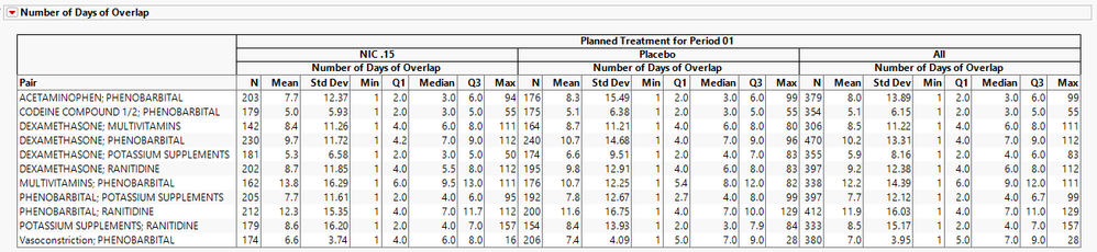

Note that tabular summaries by treatment and overall for the Number of Days of Overlap is available below the UpSet plot.
Figure 7. Summary statistics for the Number of Days of Overlap

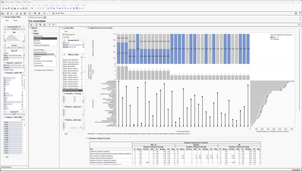

The Term of Interest list box in the Display Options makes it straightforward to select all pairs in the data filter that contain a particular term. However, it is important to clear the data filter of current selections since selecting a Term of Interest will respect current filter selections.
For example, clear the Section Filter, and select Cerebral ischaemia in the Term of Interest list box (Figure 8). All pairs that include this Term of Interest are now presented in the UpSet plot.
Figure 8. Occurrence groups with cerebral ischaemia
