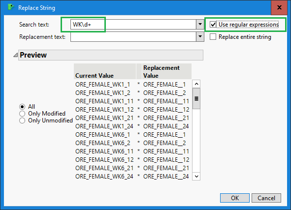

Step 3. We are best off sticking to simple regular expressions. In this case, we are searching for the letters “WK”, followed by one or more digits. \d matches a digit, and the plus sign means “1 or more”.

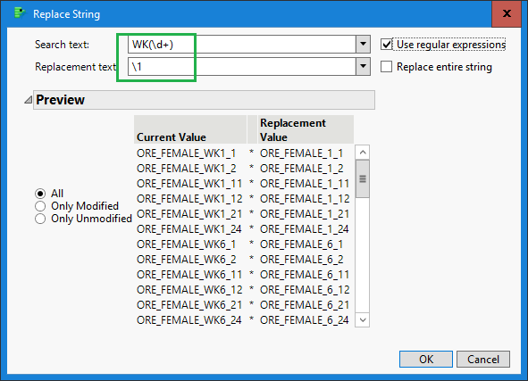

Step 4. Looking at our replacement values, we can tell that the regular expression found WK1, but replaced it with nothing. We can use \1 as the replacement text to replace the match with the first capture group. We don’t want the entire string, only the numeric portion, so we add parentheses to create a capture group.

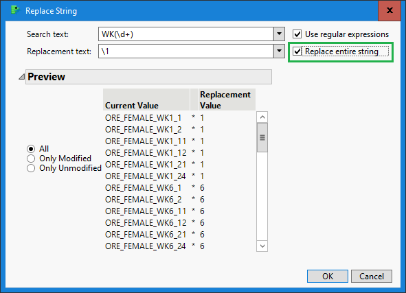

Step 5. Now, we have the number (ex. 1) in the place where the matched string was before (ex. “WK1”). However, all we want is the digit. There’s a new checkbox in Recode that replaces the entire string with the replacement value.

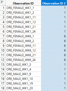

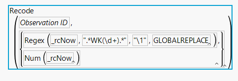

Step 6. Now we have our data trimmed down to just the WK number as a string. We can continue by parsing the string into a number as before. If we save the result as a column formula, we’ll get the following formula.
The resulting column looks like this:
