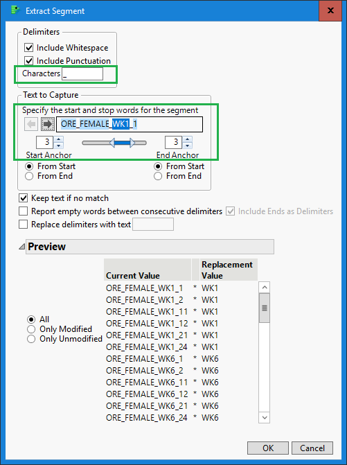

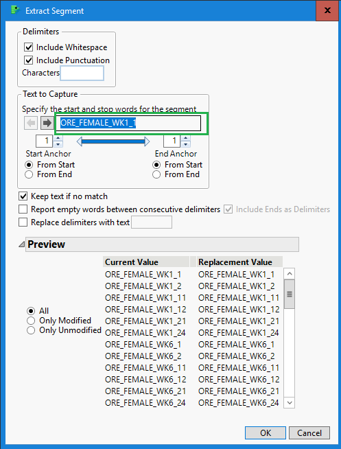

Note that the Text to Capture section shows that there is only one word in our sample text. However, for this purpose, our words are delimited by the underscore character. We’ll add the underscore as a delimiter.
Once we add the delimiter, we can see that the first sample contains four words.  I have used the slider to move the selection to the third word.  You can see in the Preview area that we are now capturing the WK portion of the string.  We use the OK button to finalize this step in our process.

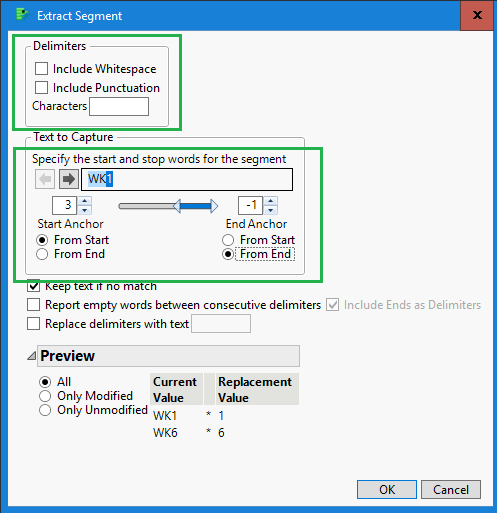

Step 3. Now that we have isolated our desired data, let’s use Extract Segment again to peel off everything but the numeric portion. If we remove all delimiters, then each character is treated like a word. Notice that I have selected the third word. However, I have also switched the end to point to the end of the string (a negative number indicates we are counting from the end of the string). We only have a single digit in this case, but if we had multiple we would be capturing from the third word to the end of the string.

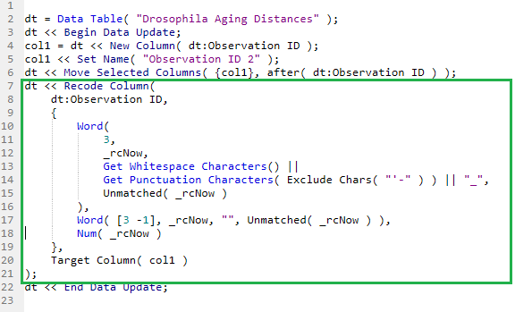

Step 5. Save to a new column or a script. Note in this script that it captured the three steps performed and can be run against new data. The Recode Column portion is very similar to the Recode command that would be written out to a formula column.

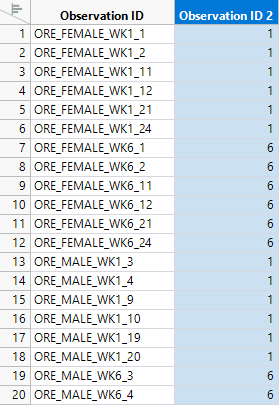

The resulting column looks like this:
