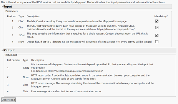

The file itself contains the definition of the function and at the end, a call of the function with an empty parameter list. An empty parameter list always opens this information window:
This function is very general and transparent about the content that you want to use it for. It is only helpful if you are interested in the offerings of MapQuest and the details of the respective interfaces. You need to build or interpret the JSON structures yourself.
