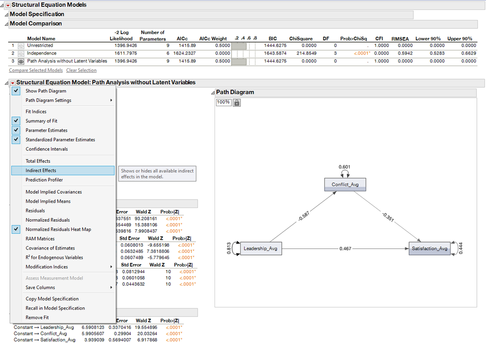

Hi, Question for @LauraCS , is there a way to get the indirect effects in a path analysis for SEM to check if the mediation is significant?
LauraCS
Staff
Hi @MDM,
Great question! Yes, we have an option under the red triangle menu for obtaining tests for all indirect effects present in the model:
The report will list the unstandardized and standardized indirect effect(s) along with their standard error, which is based on the delta method. In the context of mediation, the SEM platform can perform currently what's known as the joint significance test and the Sobel test. Bootstrapped standard errors and confidence intervals are on the works so we'll be adding those in a future version (JSL would allow you to get these now but we want to make it much easier). Lastly, version 17.0, which will be released this October, has additional visualizations for those indirect effects.
