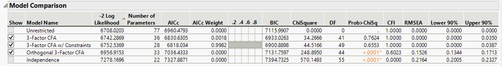

Model Comparisons
Best practices of SEM involve fitting multiple, competing models to data. Our platform facilitates this task by providing all the information you need from multiple models in one place. You can select which models to look at, or you can see them all at once.
