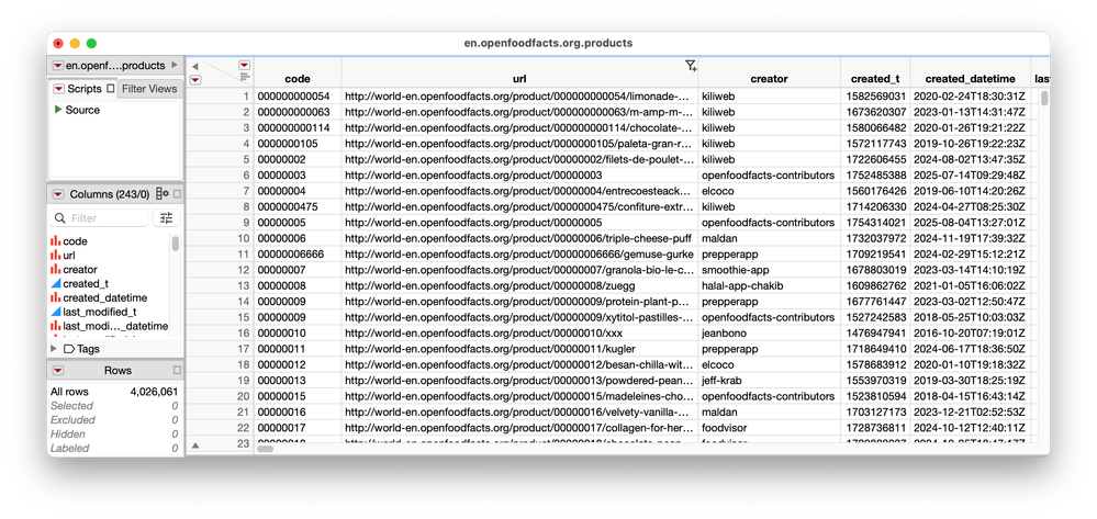

This file, however, is not for the faint of heart! The uncompressed CSV is 11.6gb, coming in at just over 4 million rows with 243 columns (as of September 2025; the database is continuously updated). Tables like these are unusually hard to navigate, but several new tools in JMP make it easy to keep things organized. Let’s start with organizing those 243 columns.

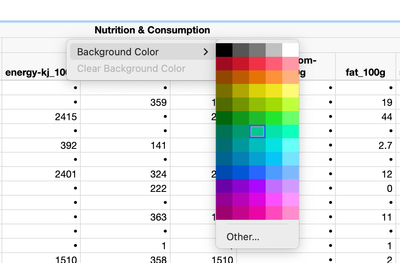

If there is a group of columns that you want to take special note of in the grid, you can right-click on the header group in the table to set a background color for the group. I’ll do that here for the nutrition group of columns.

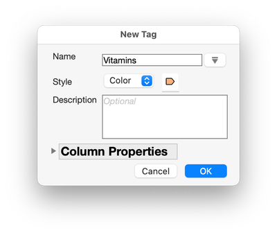

I’ll make the Vitamins tag next, this time using the + button in the Tags area.
It will create the tag, which will be listed in the Tags area of the table, but no columns will be associated with this tag until I’ve added them. I’ll select the 11 Vitamin columns, right-click on one in the columns list, then select Tags>Vitamins.

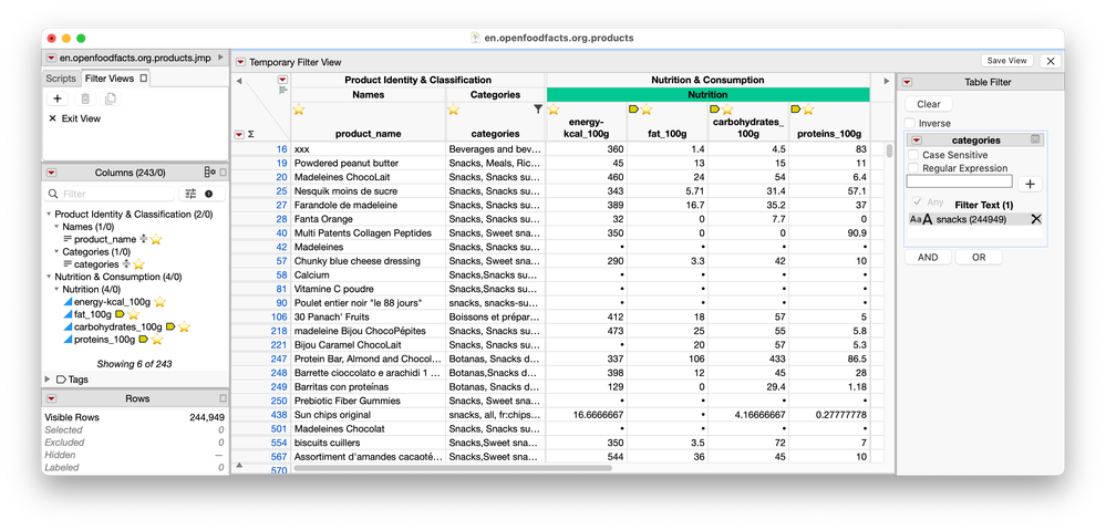

To start, I’ll click the filter plus icon on my categories column so that I can filter my table down to only certain kinds of foods.
If you’ve ever used a data filter in JMP before, you’ll recognize it on the right-hand side of the table in this new temporary filter view (the view is temporary because we have not yet saved it).
I have the categories column set as unstructured text so that I have a free text entry field to use as a search box. I’ve typed in “snacks” and set the filter to only show me those products that are in a snacks category. In this case, there are about 244k rows matching snacks somewhere in the category description.

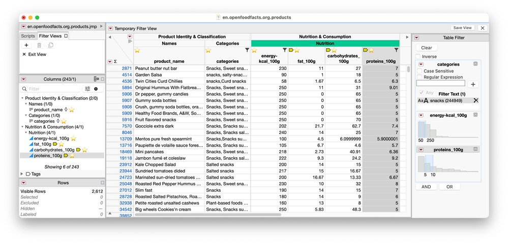

If I want to add another filter to this view, I can click the AND button in the filter, or simply hover over another column I want to add. I’ll add the Calories (energy-kcal_100g) column to my filter and set the range as 50-250. I’ll also add Protein (proteins_100g) to the filter and set that range from 5-10.
We’re left with 2,612 rows, down from the 4+ million we started with. It’s still a large number of rows, but far more navigable than the original table and might represent an important subset of the table we want to explore further.

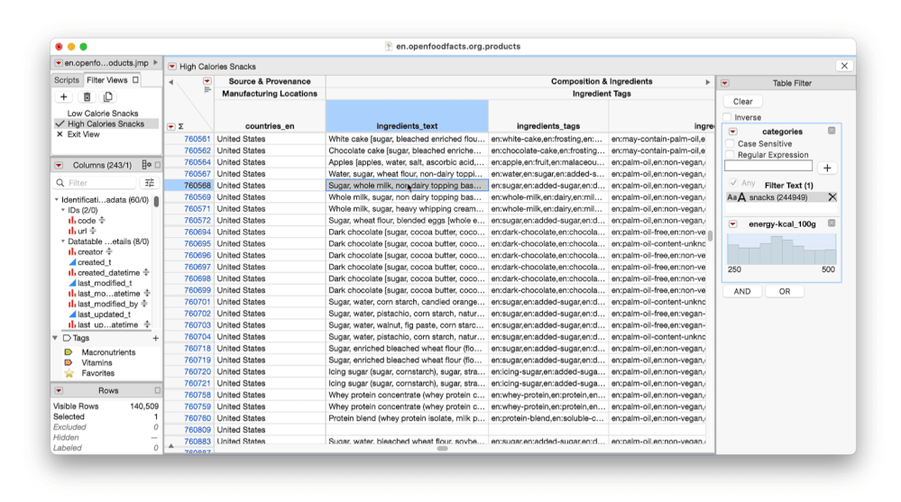

Working with filter views
Once we’re happy with the filters we have set up, we can click the Save View button in the ribbon at the top of the table. Since we have the opportunity to name this filter view, I’ll give it a descriptive name so I can return to it later.
When I click the X in the ribbon at the top of the table, this filter view closes, and we return to the original rows in the table. To bring back the view, simply click the name in the filter view tab.
