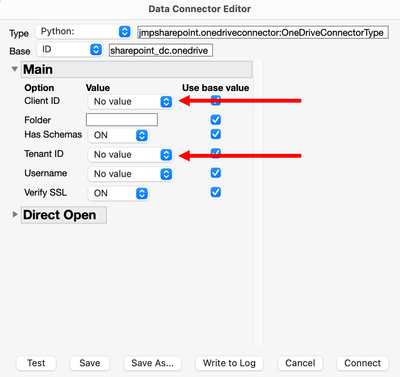

These options are dependent on the inclusion of the Tenant ID and Client ID parameters.
Option 1: JMP hosted authorization server
This option will be used automatically if you do not include the Tenant ID and Client ID in the connector editor. When connecting, JMP opens the default browser and prompts you to login to your desired Microsoft account. You are then asked to grant access to the SharePoint Data Connector application.
