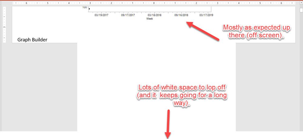

Hi @MaryLoveless , this is very helpful.    How do I solve the extra white space that gets printed with this solution?  I'm using PowerPoint 2016 on a Windows machine & JMP 14.0.  I tried all three graphic export options and none solved this issue.
Graphic format options and results
  • PNG - the big whitespace issue. Waaaay off the bottom of the slide.  Hard to crop because PowerPoint wants to flip to the next slide when you scroll down.
    • My work around is select the image in PowerPoint, > Format (at the top) > color > set transparent color > then click the extra whitespace on the image.
  • JPEG and EMF - still whitespace, but the picture is shrunk to fit vertically on the slide.
    • My work around is to manually crop and then stretch enlarge the image.
Thanks.

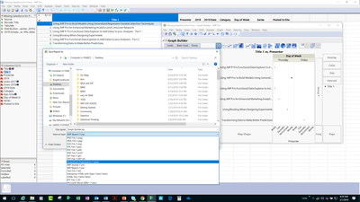

From the Graph did you try FILE>SAVE AS>PowerPoint Presentation?  When you do that, you can edit the picture.  For example, I just dragged and dropped the simple Editable Graph Builder.pptx to fill the space.  I attached the .pptx file to this blog for you to see.

I, too, would like to know how to get plots to PowerPoint without all the extra white space at the bottom. I created a graph in Graph Builder with a variable in the Page box, thus creating 10 plots. When I saved as PowerPoint, each plot was put nicely on a separate PowerPoint slide, but every plot image had this huge whitespace at the bottom as the earlier responder pointed out.
Frankly, I think this is a glitch that JMP needs to fix. I'm using Office 365 and JMP 14, the latest release.

Hi, JMP developer here...
Yes, this is a bug in in JMP. It has been fixed in the forthcoming JMP 15 but unfortunately, I don't have a workaround to offer for folks using JMP 14. Sorry for the issue, I'm sure it's frustrating!
John
