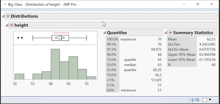

If you want to save the whole report output with graphs, simply choose Edit > Copy to store the active window to the clipboard and then paste the results in your document.

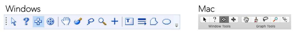

You can also save just a portion of the results by choosing the Selection Tool (or “fat-plus" tool) from the toolbar (or Tools>Selection) and then clicking on the table, column or graph you would like to save. You then copy and paste as before.
For example:
a. From any JMP output window, click on the selection tool in the toolbar (the fat plus)
b. Click on the content you want to copy. The selected content is highlighted. To extend a selection, hold the Shift key

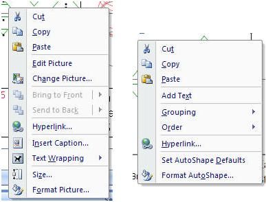

d. Open the program where you’d like to paste the content. On a Mac select Paste. On Windows, if using a Microsoft Office product, such as Word or PowerPoint, select Paste>Paste Special. From the list, select Picture (Enhanced Metafile). By selecting Picture (Enhanced Metafile), you have the ability to grow and shrink the image, ungroup the image for manipulation. This options also takes up less storage space. Once the image has been pasted in your application, if you right-click within the image and select Edit Picture, you then have the ability to manipulate that image.
