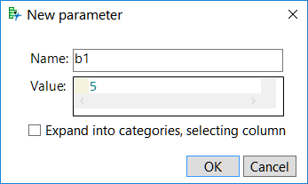

To enter this as a column formula in JMP, the first step is to define the parameters and their starting values. To begin, create a new column in the data table and add a column formula. In the Formula editor, change the list choice in the center bottom panel from Constants to Parameters.
Click on New Parameter. In the dialog box that opens, provide the name of the parameter and the starting value as shown.
 Repeat the process to enter each parameter in the model along with its starting value.
