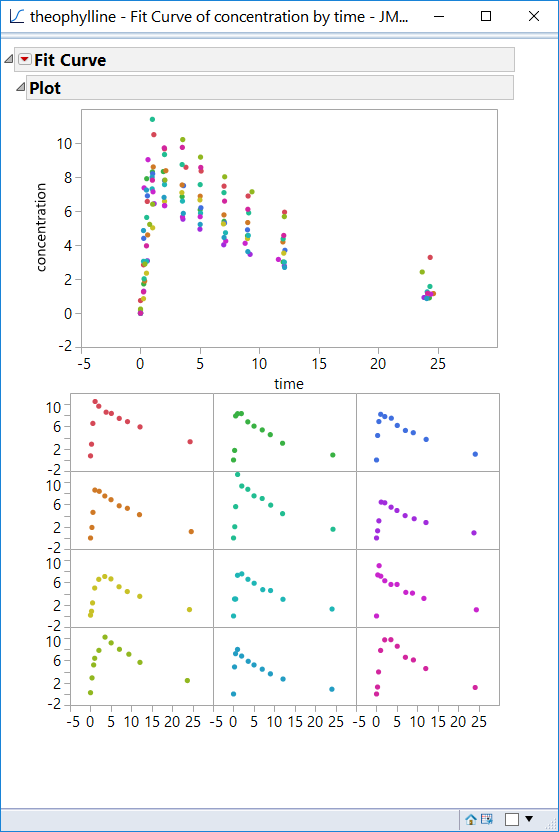

To use the Fit Curve platform to fit the model to the data, select Analyze --> Specialized Modeling --> Fit Curve. (Note: Prior to JMP 13, the Fit Curve platform was part of the Nonlinear platform and was accessed by selecting Analyze --> Modeling --> Nonlinear and assigning a column without a formula to the X role). Assign concentration to the Y role and time to the X role. In this case, use subject in the Group role to fit separate models for each of the subjects in the study. This will allow you to compare the model parameters between subjects. Select OK and graphs of the data are displayed.

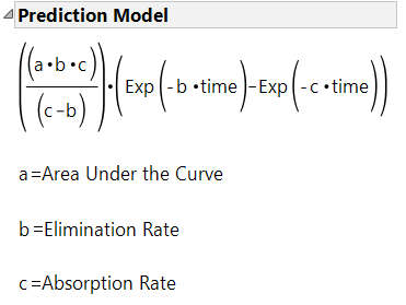

The Prediction Model displays the model formula, including the parameters. When appropriate, physical interpretation of the parameters is also shown. In the case of the one compartment oral dose model, the parameters represent the area under the curve, the elimination rate, and the absorption rate.

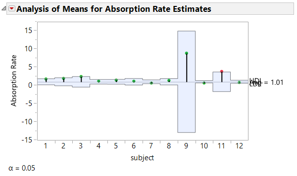

For this model, there are three parameters estimated for each of the subjects. Analysis of means can be used to compare the parameters across subjects. To generate the analysis of means decision charts, click on the red triangle next to the model name and select Compare Parameter Estimates.
On the analysis of means plots, any point that is outside the shaded area is considered statistically different from the others at the 0.05 level of significance. These statistically different points are also red rather than green. For each category of parameter estimates there is at least one subject for whom the parameter estimate is found to be statistically different than the others. For example, in the last plot shown, the absorption rate estimate for subject 11 is different than the estimates for the other subjects. This is an indication that a single model may not be appropriate for this data. It may also prompt additional examination of patients 1, 10, and 11 to see if there is a particular demographic or medical history reason that they are different from the other subjects.

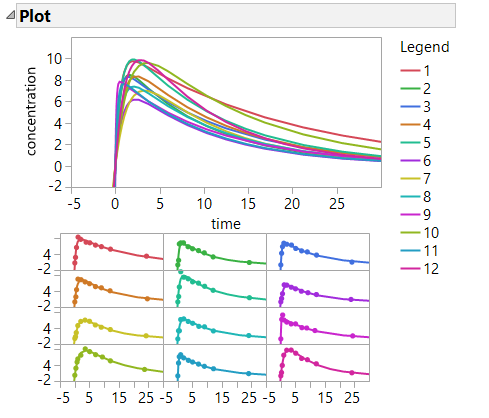

A series of plots are also provided to illustrate the models that are fit. There is a single plot that overlays all of the subjects, and a matrix of plots that shows each patient individually.

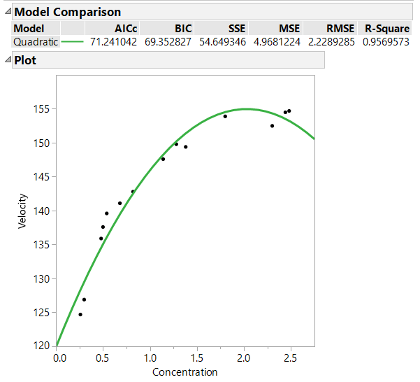

At first glance, one might consider fitting a quadratic model to this data. While a quadratic model is not nonlinear, such polynomial models are included in Fit Curve for ease of comparison. Fit a quadratic model by selecting Polynomials --> Fit Quadratic from the red triangle menu.
The R-Square statistic is quite high. However, you might be concerned about the predicted velocity beginning to decline at a certain point in time. Assuming that this decline is not possible in this circumstance, a growth model might be more appropriate. Fit both mechanistic growth and Michaelis Menten models to the data by selecting Exponential Growth and Decay --> Fit Mechanistic Growth (and Fit Michaelis Menten) from the red triangle menu. Examine the results.
