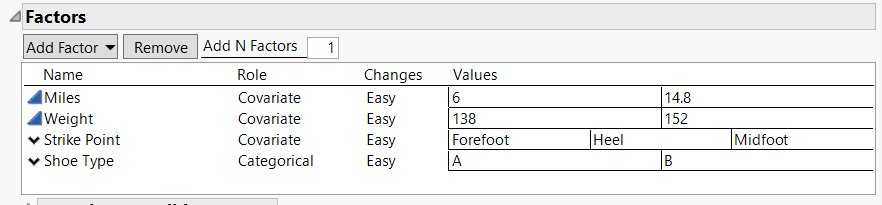

Say we wanted to use a subset of 24 of these runners with an additional controllable factor for shoe type (A/B). Clicking the Select Covariate Factors button, we can choose all three factors as covariates:
We now get an embedded table within the Custom Designer:
We can now add a factor for Shoe Type:
and modify the model, however we see fit.
