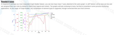

Parallel Y axes
In response to perhaps our most requested Graph Builder feature, you can now have many Y axes attached to the same graph. In JMP fashion, all the axes are live and are assigned their own color by default to match their legend and content. The graphs will look confusing to many, but they’re essential in some process monitoring applications. By the magic of Graph Builder, any combination of element types is supported, though connected lines are most common.

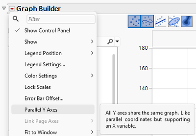

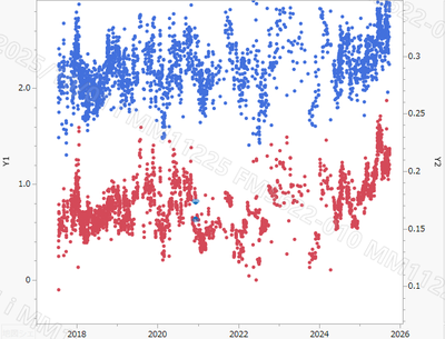

How can I use Parallel Y axes? There has been an option since earlier versions to move the Y axis to the right side, but I couldn’t figure out how to display multiple Y axes grouped on the left, as shown in the figure. Please let me know.
hogi
Level XIII
The option can be activated in the Red triangle menu.

EdgeDromedary53
Level I
@hogi
Thank you, I did it.
sorry it’s in Japanese.
