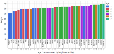

We wondered about the new behavior:
it always worked.  And "today" -- why are the main groups split into small chunks ?

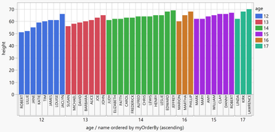

@shannon-c-b , thanks for pointing to the root cause of the "bug":
As a workaround, one can create an auxiliary column to simulate the default (JMP ?-18) functionality of  order by () with JMP19:
New Column( "myOrderBy",
	Formula( Col Mean( :height, :age ) * 10000000 + :height ),
) << run formuals();
Graph Builder(
	Variables(
		X( :age, Order By( :myOrderBy, Ascending, Order Statistic( "Mean" ) ) ),
		X(
			:age_name,
			Position( 1 ),
		Y( :height )
	Elements( Bar( X( 1 ), X( 2 ), Y ) )

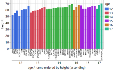

Hi @shannon-c-b
important: my workaround is not an exact 1:1 copy of the JMP18 style.
[TS-00240917]
my workaround:
- sorts the ages by mean(height)
- sorts the students by height within the age groups
JMP < v19:
- sorts the students by mean(height)  -> stores the order (*)
- places the students into the respective age groups - position by  (*)
as Robert shows up twice, Robert is positioned by mean(height)
-> Please note the jumps around Robert #1 and Robert#2
my application case is for "students" with unique names, this is why I did not notice the difference.
If your dataset contains "students" with duplicate names and the above workaround is not suitable for you (i.e. if you require the specialty (*) ), please contact JMP Support (referencing TS-00240917). They will be able to provide a workaround.
