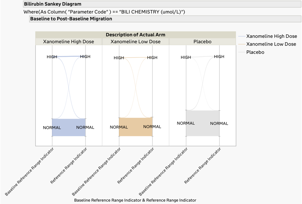

Migration of Patients from Baseline to Post-Baseline Lab Levels

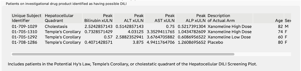

List of Subjects with Possible DILI

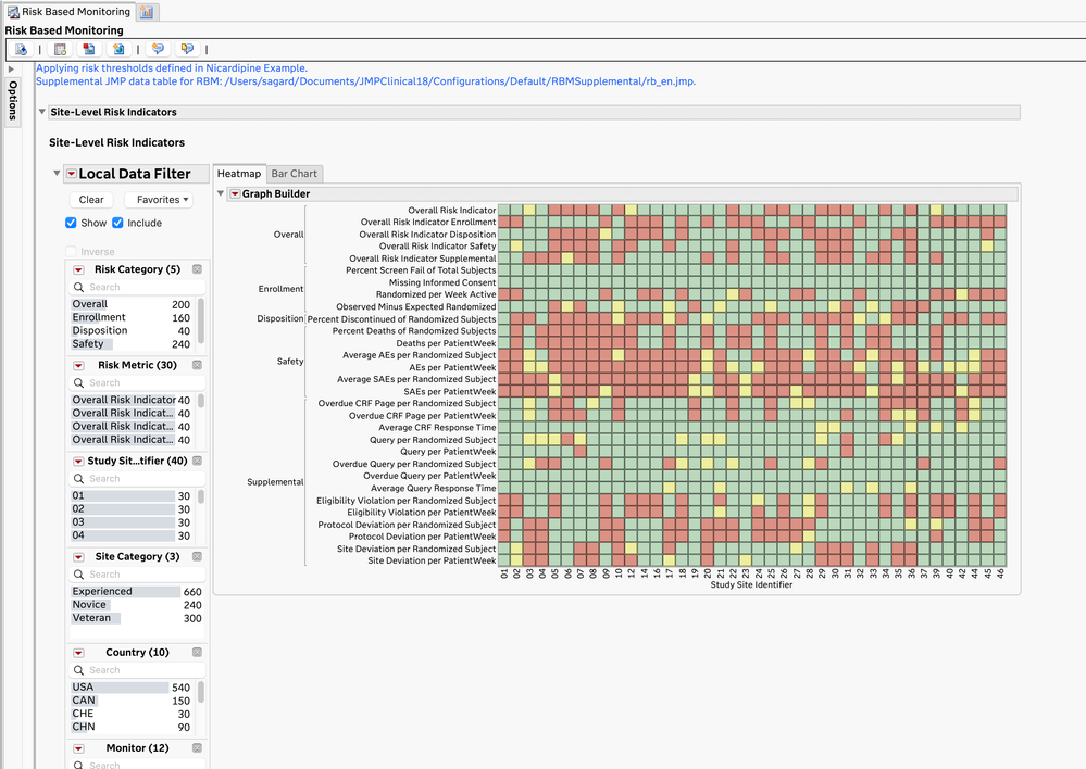

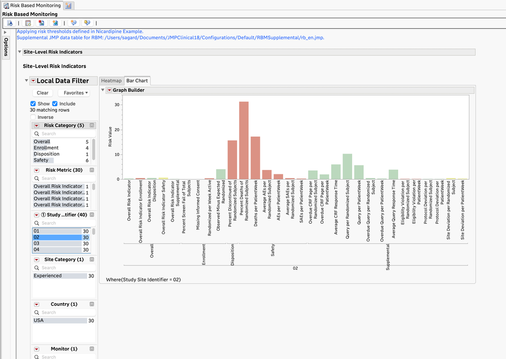

  • The JMP Clinical Risk-Based Monitoring report shows a high-level, filterable summary of the risk metrics by site (and optionally, by monitor and vendor) and allows for closer examination of the risk metrics at each site.
Site-Level Risk Value Heatmap
Risk Values for Specific Site

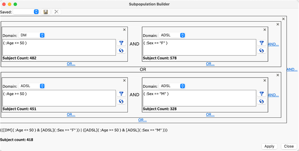

The planned and exploratory analysis that is typically performed on clinical trial data often requires identifying and/or filtering to a subset of subjects that meet conditions that can be defined by the data. Traditional approaches to developing complex rules for selecting subsets of subjects have required code-based conditional statements or queries. The Subpopulation Builder is a new GUI-based approach in JMP Clinical 18 that allows you to specify complex queries across all the clinical data domains so that you can filter to the subjects of interest.  This new approach is easy to use and does not require coding.
Subpopulation Builder addresses our users’ desire to easily use complex cross-domain queries that are important to them and that are focused the type of analysis they want to do. These subpopulation queries can also be modified manually using JMP Scripting Language when an even more complex query is needed. Finally, these subpopulation queries can be saved and applied as filters directly to the study reviews in progress, automatically updating the analysis to focus on just those subjects of interest.
Query: All females under age 50 and all males 50 and older
All males 50 and older with a bilirubin lab result >= 30000

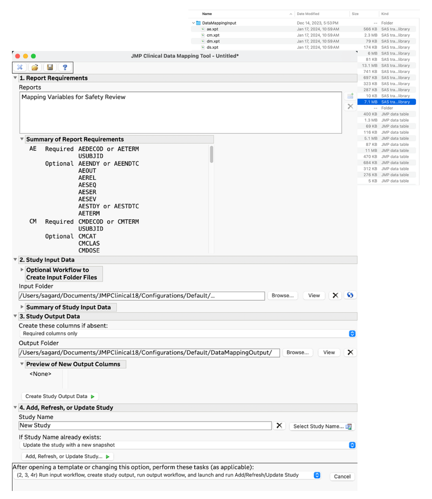

The Clinical Data Mapping (CDM) tool is an add-in for JMP Clinical that allows you to go from raw clinical data to transform, map, and load that data as a study in JMP Clinical.
Many organizations and reviewers lack resources or systems to provide them with CDISC standard SDTM data files as input for clinical data analysis tools. This new tool facilitates that process and enables users to prepare clinical data – in a repeatable way – so that it can be loaded into JMP Clinical for study review.
The starting data can be in any form that JMP can read in, including text basedfiles, Excel workbooks, SAS data sets, and JMP data tables.
A minimum list of required variables is displayed, and you can import, transform, and/or map your data to the required variables. Pre-processing is facilitated by allowing the use of JMP workflows from the Workflow Builder, and post-processing the prepared data can also be done with a workflow. The data mapping can be driven manually, step-by-step, until you have your data ready for input, and then you can pass that prepared data to the Import Study tool in JMP Clinical. All of this work can be saved so that you can document the process that you used to get your data ready. It is also reusable so that you can also reapply the same steps to data when you get new or updated data.Screenshot 2024-02-06 at 09.27.41.png
