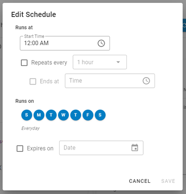

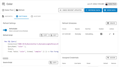

  1. Data Refresh and Scheduling. Report publishers are now able to refresh their report data directly from JMP Live, and they have an easy way to schedule the refresh of their data within JMP Live.

What problems do the changes solve for our users?
  1. Site administrators do not need to install JMP PV on a separate server just to run refresh scripts
  2. There is no need to use and learn the Windows Task Scheduler.
What are the impacts this can make on users’ work and on organizations?
  1. Everything can now be managed in one place – JMP Live.
  2. Users will not need to learn Windows Task scheduler or ask their IT department to set up tasks for them.

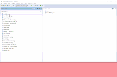

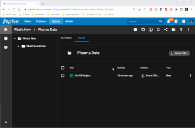

Data has been elevated to a "first-class citizen." A JMP user can publish data directly to JMP Live (without a report). A JMP user can publish a report that uses existing JMP Live data; the report and the data do not have to be in the same folder.  Also, a JMP user can preview data in JMP Live before downloading it.

Publishing data directly to JMP Live (without a report)
Publishing a report which uses existing JMP Live data
Previewing data in JMP Live before downloading it

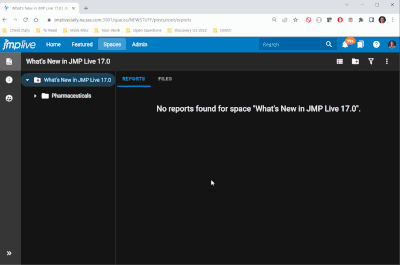

JMP Live Spaces
What changed?
Data and reports are published to spaces.  A "space" is just a place to put related content. Users with admin rights create spaces and decide who has access to the data and reports in them. Some spaces will be set up for existing JMP Live users automatically during the migration to 17.0.
