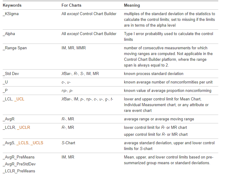

@tonya_mauldin  Is there a way to do more than spec limits? I need specs, control, etc. Also, where is the option for response limits in the _Limitskey function. The get _lmitskey has more options to use, but the Manage Spec Limits feature doesn't not use all these options.
tonya_mauldin
Staff
The Manage Spec Limits platform is solely for specification limits.  There is no functionality for control limits or response limits in this platform.  I will forward your request to the developer.

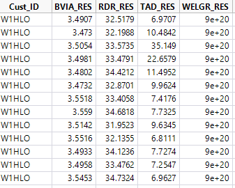

HSS
Level IV
Data table --
Specs Table --
Script using --
dt = Data Table ("Specs_Limits");
dt = Data Table ("Table_A");
dt << Manage Spec Limits( Y( :BVIA_RES, :RDR_RES, :TAD_RES, :WELGR_RES ), Load from Limits Table(Specs_Limits) );
Error ---
Any help ?
Name Unresolved: Specs_Limits in access or evaluation of 'Specs_Limits' , Specs_Limits/*###*/Exception in platform launch in access or evaluation of 'Manage Spec Limits' , Manage Spec Limits(/*###*/Y( :BVIA_RES, :RDR_RES, :TAD_RES, :WELGR_RES ),
	Load from Limits Table( Specs_Limits )
In the following script, error marked by /*###*/
Manage Spec Limits(
	Load from Limits Table( Specs_Limits/*###*/ )
Manage Spec Limits[]
Byron_JMP
Staff
The first thing I would try:
Save the Script and the two data tables to the same folder.
HSS
Level IV
Hi Byron,
I did it, but still the error is same. Any other suggestion ?
Thanks.
tonya_mauldin
Staff
I see two issues.
1) dt has been assigned to both Specs_Limits and Table_A.
2)Load from Limits Table( Specs_Limits ) should be Load from Limits Table("Specs_Limits.jmp")
Because you specified Spec_Limits, JMP is looking for a variable named Spec_Limits which does not exist.
HSS
Level IV
dt = Data Table ("Table_B");
dt2 = Data Table ("Table_A");
dt3 = dt2 << Manage Spec Limits( Y( :BVIA_RES, :RDR_RES, :TAD_RES, :WELGR_RES ), Load from Limits Table("Table_B.jmp"), Save to Column Properties (1) );
dt3 << close window;
Hi Tonya.
Everything is sorted out. Many thanks
