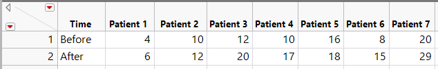

Let’s discuss a case where using the Transpose platform would be necessary. Say there are patients in a clinic and a certain measurement is taken from each before and after some type of procedure or event. The data is collected in the structure below, with the measurements for each patient entered in only two rows (one for the Before measurement and one for the After), with a new column for each patient.
However, we are interested in using JMP to perform a paired t-test (because the Before and After data values are dependent on one another), which will help us determine whether the two samples (before and after) are significantly different from one another.
To do a paired t-test, we need to use the Matched Pairs platform in JMP (Analyze -> Specialized Modeling -> Matched Pairs). To run the analysis, we must have the Before measurements for each patient in one column and the After measurements in another. In other words, we need the rows Before and After to become the columns, and we need each Patient column to become a row in the new data table.
To do this, simply go to Tables -> Transpose, and place all Patient x columns in the Transpose Columns box. Place Time in the Label box. The result is:transpose2.png
