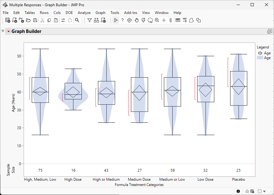

For example, the script Treatment Groupings Box Plot produces the analysis in Figure 3. Placing Formula Treatment Categories in the X drop zone effectively creates virtual observations for the different groupings of treatments that are summarized alongside the individual treatment levels. The sample sizes presented in the lower Y axis confirm that the grouped levels coincide with the appropriate sums of the individual levels. The addition of a 5 Number Summary (not shown) provides summary statistics corresponding to each box plot.
Figure 3. Box plots by treatment groupings

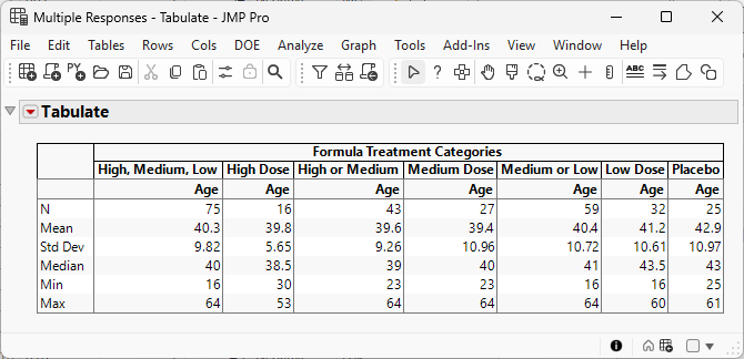

Similarly, the embedded script Treatment Groupings Tabulate produces a set of summary statistics for each of the levels present among the multiple response column (Figure 4).
Figure 4. Summary statistics by treatment groupings

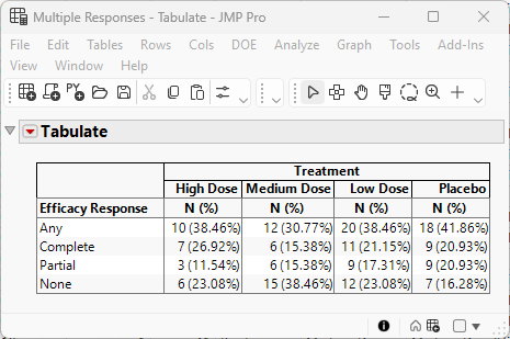

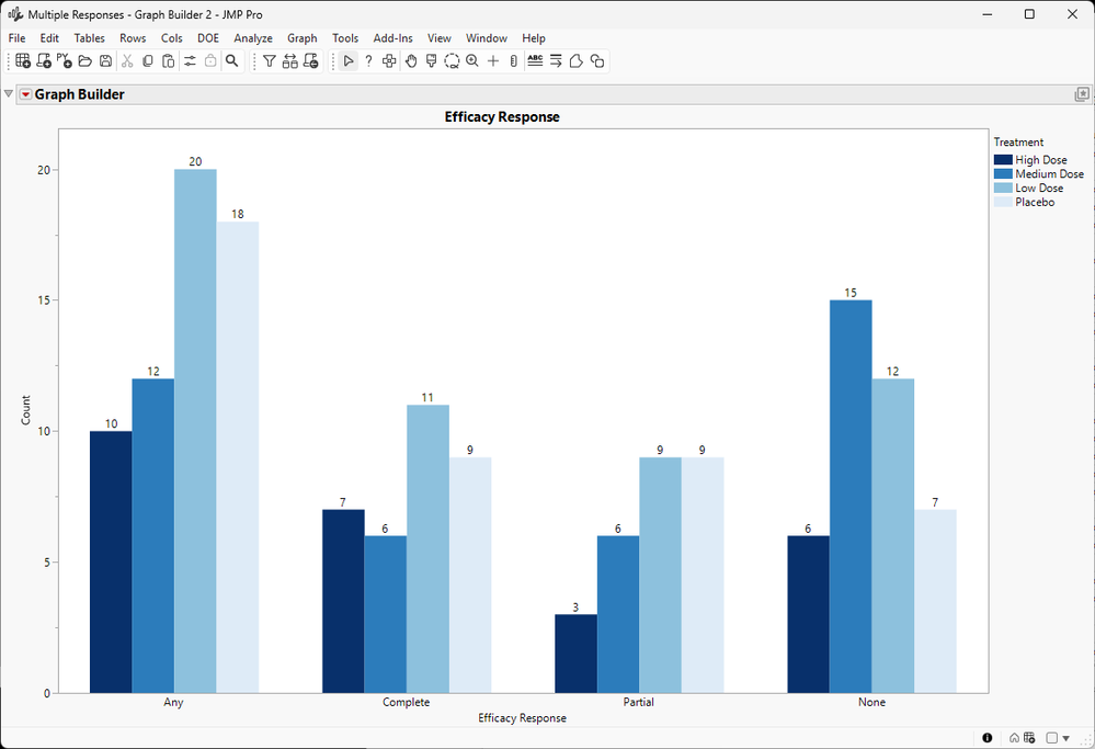

Turning our attention to the Efficacy Response column, the embedded script Efficacy Response Bar Chart produces Figure 5, which summarizes the frequency that each response occurs, including the combined levels of Complete and Partial. The sample size labels presented above the bars confirm that the frequency Any response is the sum of the individual levels of response. The script Efficacy Response Tabulate provides a tabular display using the Pack Columns option to provide the format typically found in the scientific literature (Figure 6).

Figure 5. Frequency of responses by treatment
Figure 6. Frequencies and percentages of responses by treatment

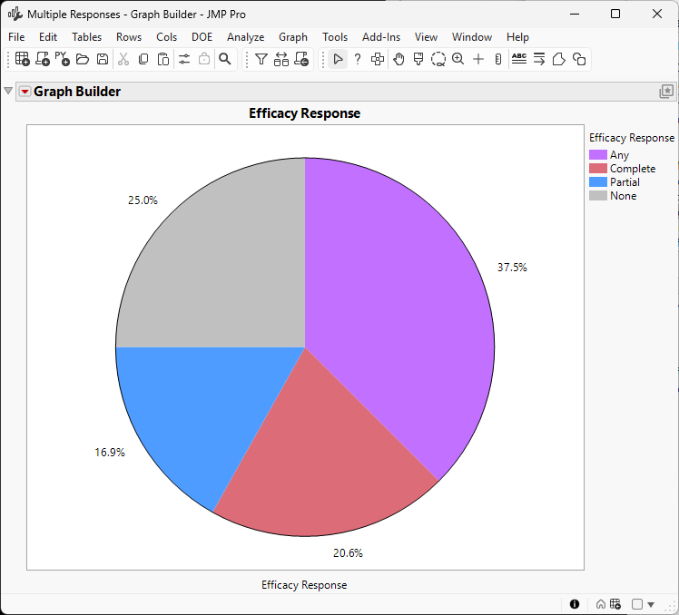

Though the multiple response modeling type is useful, there are instances where its application may not make sense, such as visualization elements that communicate "parts of the whole," such as pie, mosaic, and tree map. For example, the pie chart in Figure 7 produces percentages based on a denominator of 160 due to the virtual addition of 60 observations with Any response. Further, it suggests Any response is a level distinct from Complete or Partial rather than the combination.

Figure 7. Pie chart of responses
