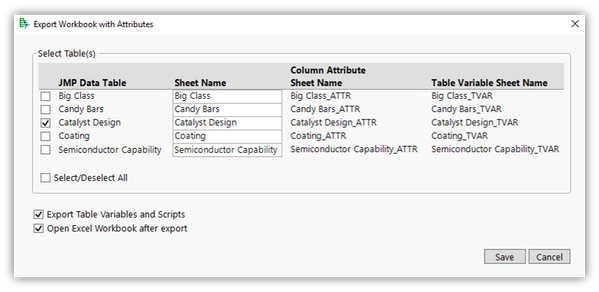

Step Three:  Select the data table(s) you wish to export
You can opt to exclude table variables and scripts in the output. However, they will not be available when imported back.
Additionally, you can also deselect the checkbox to prevent the add-in from opening the workbook after exporting.

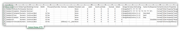

Sheet Two:  Column Attributes
The second sheet contains the attributes for the source JMP Data Table. Do not edit this sheet as it may result in errors when importing back into JMP.

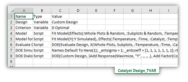

Sheet Three:  Table Variables and Scripts
The third sheet will contain the table variables and scripts for the source JMP Data Table. Do not edit this sheet as it may result in errors when importing back into JMP.Table Variables and Scripts Tab.png

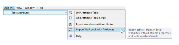

Importing a Previously Exported Excel Workbook to a JMP Data Table with Table Attributes
Step One:  Click Add-Ins > Table Attributes > Import Workbook with Attributes
