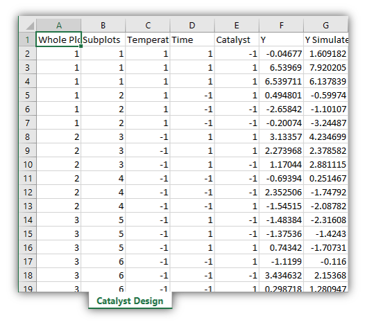

Sheet One:  The Data
The first sheet will contain the actual data from the source JMP Data Table.

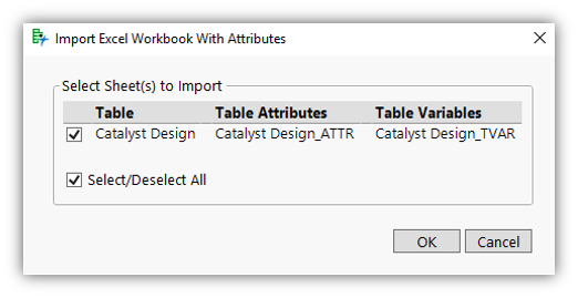

Importing a Previously Exported Excel Workbook to a JMP Data Table with Table Attributes
Step One:  Click Add-Ins > Table Attributes > Import Workbook with Attributes
Step Two:  Select Excel Workbook from Windows Explorer/Finder Prompt
Step Three:  Verify data, attributes, and variable sheets were identified successfully and deselect any unwanted tables
Step Four:  Click ‘OK’ to import the data table
