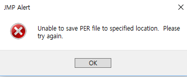

What if you get the "Unable to save PER file to specified location" errror? No worries!In JMP Licensing Blues, Part 1, we talked about the “Error While Processing JMP License File” error message. That is one of the most common errors that appear when licensing your JMP software.
In Part 2, we will discuss its cousin “Unable to save PER file to specified location,” which is another common error message. Let’s get to it.

The issue arises when JMP is unable to save the file in the default location. The issue is related in how Windows and Mac OS protect the default locations. Most commonly, the issue directly affects JMP’s ability to overwrite the existing JMP.PER file. The easiest way to resolve this issue is delete the existing JMP.PER file.
